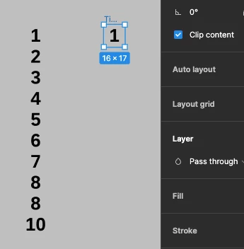

I am working on a project that has a time picker. I almost have it perfect, but all of the numbers keep showing on my on my frame rather than them just being visible when scrolling through the time picker. Does anyone know how to resolve this issue? Here is the link to my project

You can reduce the height of frame in which numbers are present and enable Clip Content.
