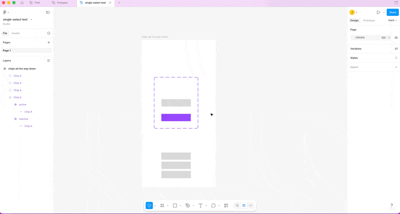

    I made a quick example to test per-instance conditional in Figma Design binding:
    • built a 2-variant chip component (active/inactive)
    • placed 3 instances
    • bound each instance's State property to a single string variable
    • changed the variable's value
    Result = all 3 instances flipped together and no per-instance conditional in design-mode binding 😢
    My quick gif of the test
    My example is interesting and taught me a few new things and I am not sure if it is scaleable at the level you are looking for with potentially hundreds of chips. Might be worth submitting as a Feature Request. I hope this helps get you moving forward! — Jaycee
