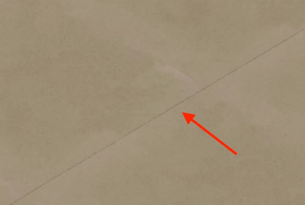

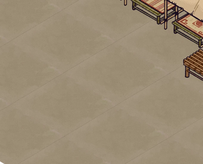

I use figma to make an isometric map and I have to duplicate several images to make a background but when I see it in prototype, these black line appear bettween the images’ edges and I don’t know why. How can I fix this? Please help me, thank you all so much.

Hi ​@Trang Tran, thanks for reaching out about this!
I noticed that black line in the second screenshot you shared – it looks like that's what's causing you trouble, right?
Upon checking, it seems you've stumbled upon a long-standing bug that our team is already tracking, especially if you're using an image with transparent parts.
Could you take a quick look at the image you're using as a Fill? If it does have transparent sections, a potential workaround you could try is to avoid using a transparent frame altogether. Instead, try filling the frame with the background color of where it's going to be used.
While we can't give you an exact timeframe for when this will be fixed, I've added your post to the existing report to help bring it more attention in the meantime. Every bit of info helps!
If that's not what you're seeing, I'd suggest submitting a bug report so our team can take a closer look at your specific case.
Thanks again for reaching out and letting us know about this! We appreciate you bringing it to our attention.
