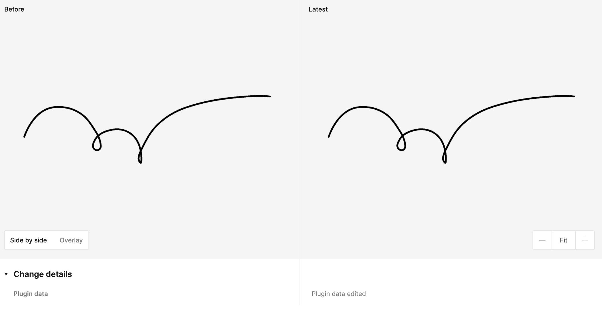

I found that it happens setPluginData on figma.root, but doesn’t happen on a PageNode.
When I setPluginData on a PageNode then I can merge as I expected. Also, I can see the diff in the branch review window.
