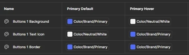

In my "Button 1" collection, I have:
On my Design System file :

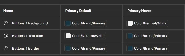

On my Theme Client A file :
As you can see, there are no direct values (no hex colors). Each value is an alias.
I have the same architecture in my design system and in my Theme client A file. The only difference is that in my design system Color/Brand/Primary = #406eff, while in my Theme client A file Color/Brand/Primary = #003746.
