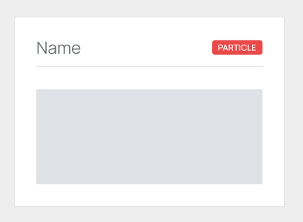

I am creating this plugin to be able to store my components in a well organized way.
To do this i have a component set called “Object Organizer”.
It looks a bit like this:
This object has a Name and a Dark and light mode.
I am able to handle those things and be able to create an instance, easily thanks to a beginners tutorial.
Now comes the tricky part. ¿See this red tag with the label “Particles”?, This is an instance of another component within “Object Organizer”.
When i launch the plugin, i get to choose a name, choose between Light or dark mode. and then select a tag to display (Module, Element, Particle… ).
I would like that the new instance i create was wearing the selected flag just fine.
