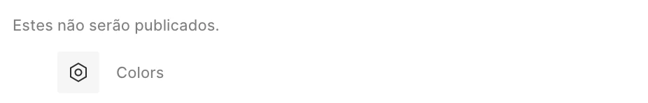

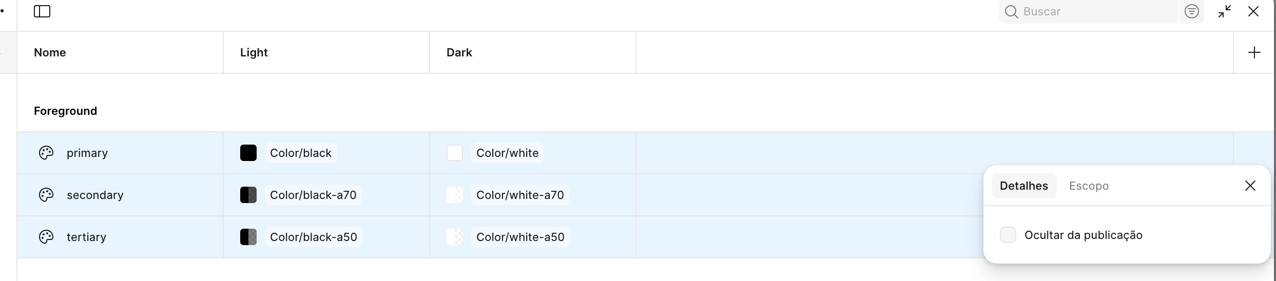

João Montenegro
Oct 7, 2025 6:16 PM UTC
Hi, I have the same issue and I can’t find a solution. I’ve created my variables directly inside my library file but I can’t publish them as they appear as hidden elements in the publishing panel even though the “hide for publishing” is unchecked for all my variable… Did you find a solution for this problem cause I’m stuck with this one?
1. The variables are being treated as unpublished (even though the “Hide for publishing” option is unchecked).

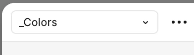

2. I solved this issue by adding an underscore _ before the variable collection name.
After that, I removed the underscore — following the final step in this tutorial: Hide styles, components, and variables when publishing.

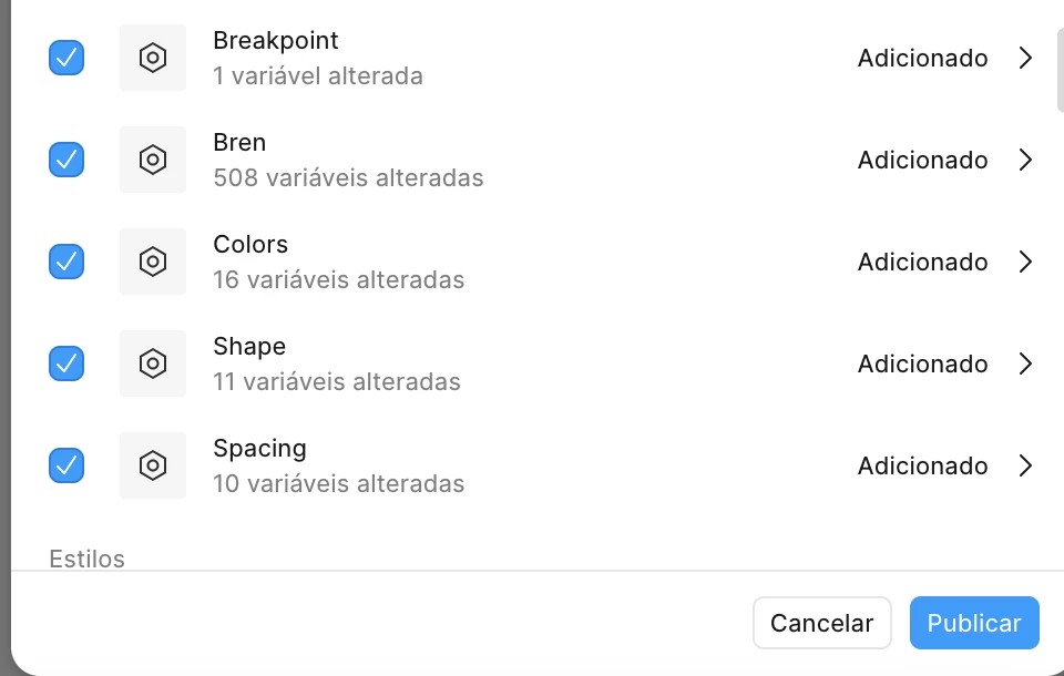

After doing this, the variable collection appeared automatically in the publish list.
