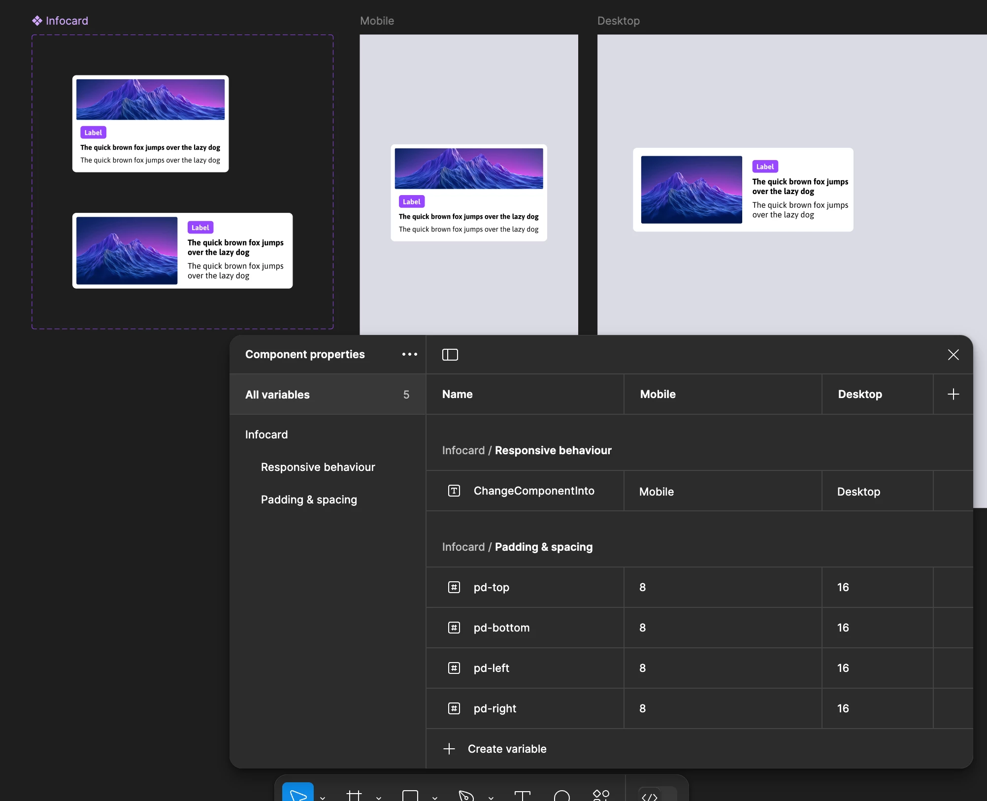

Setting up Responsive variables
Hi all!
I am trying to set up a small variable system with responsive behavior for my team. The feature with the adaptive modes is really interesting.
In this example, I am trying to add padding to the desktop 'Infocard'. As you can see, it works within the frames, so no matter where I drop the component, Figma automatically uses the correct component instance.

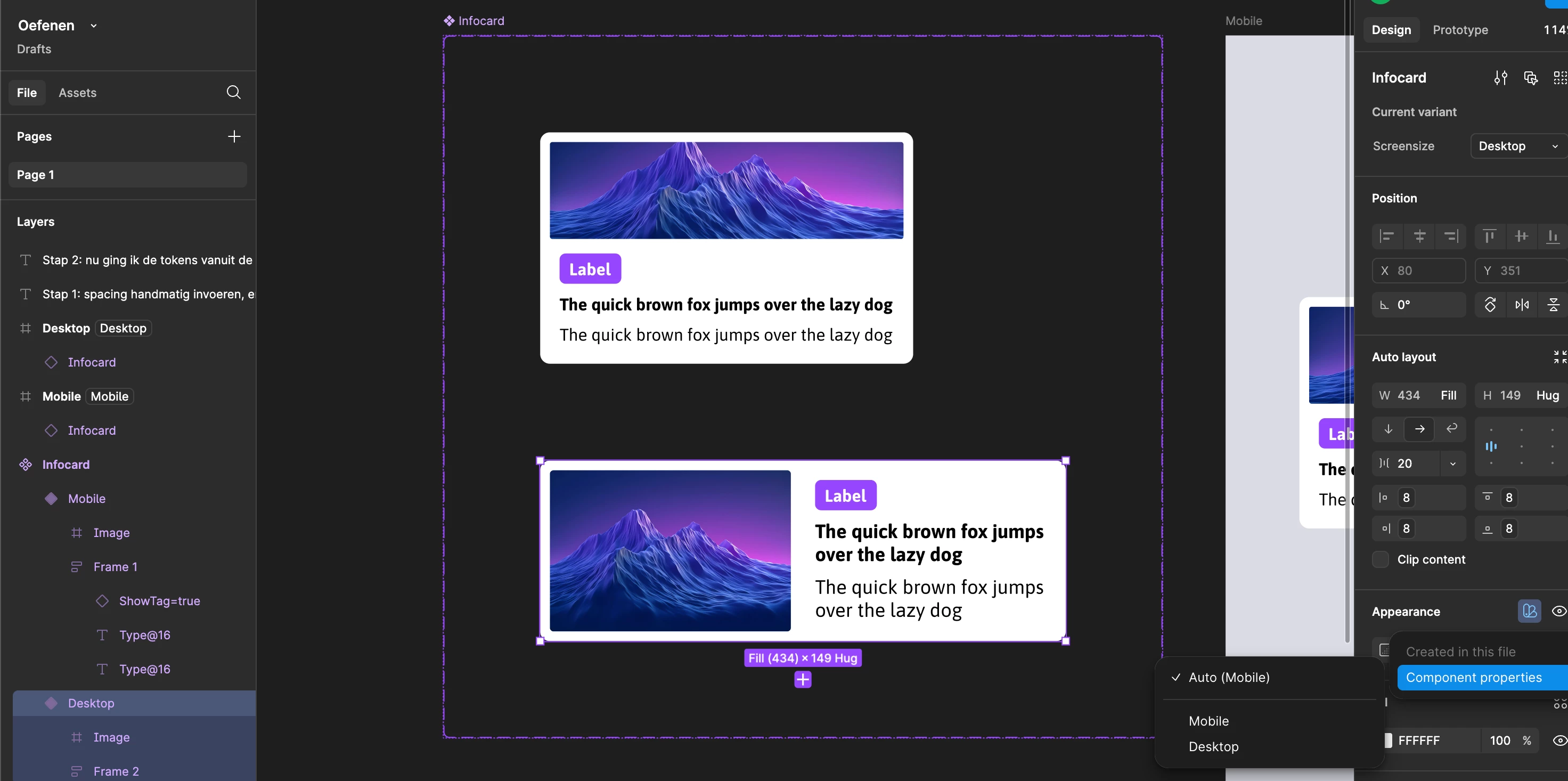

The problem: In the Infocard component itself, I can assign the correct mode to each instance via the Appearance panel, but this breaks the automatic ‘drag-and-drop’ functionality.
Variables. Everything works in the mobile and desktop frame. But not the ‘Infocard’ component
I could change it here in the appearance panel, but then the responsive modes won’t work
