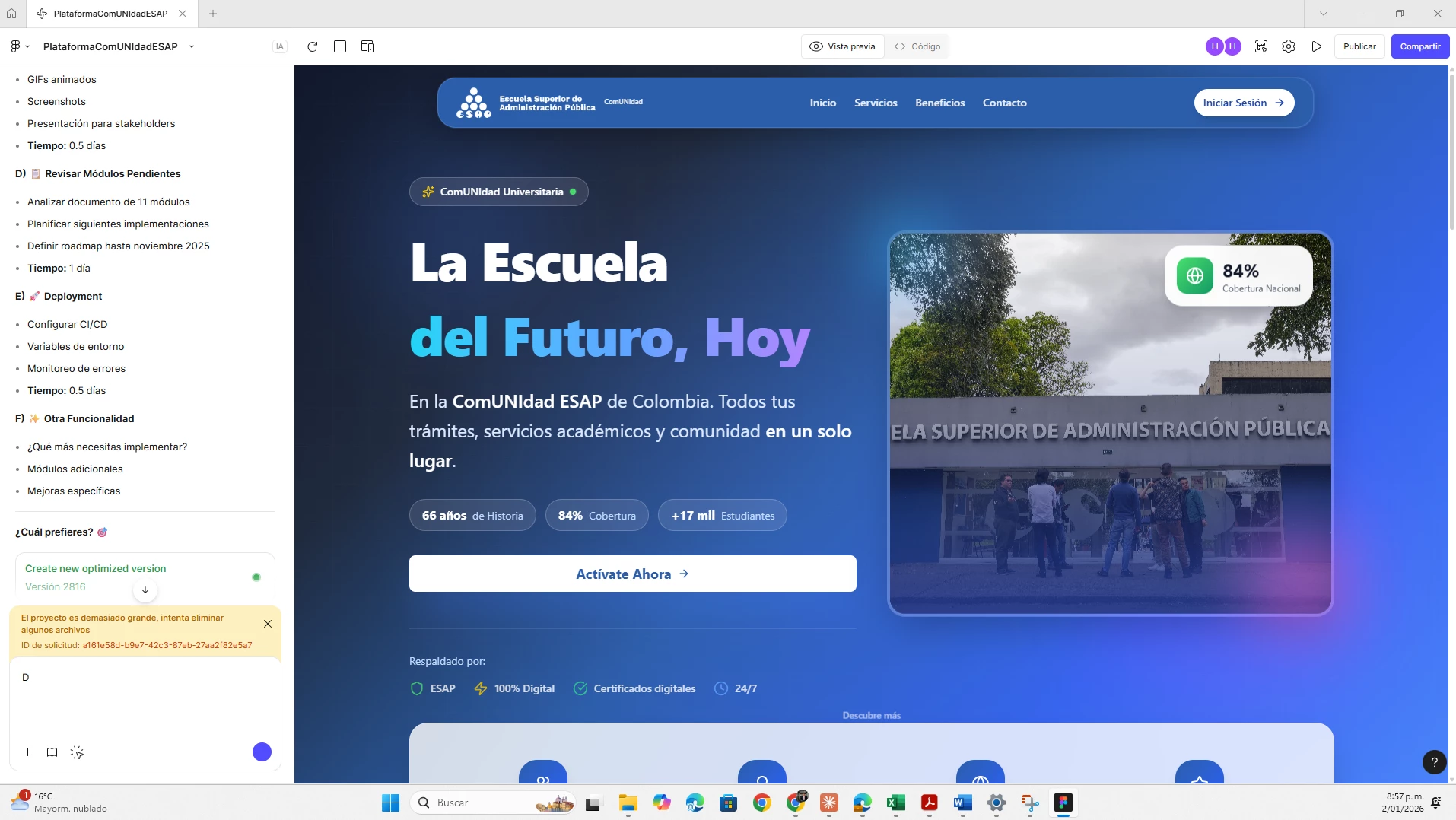

    Hernan Buitrago
    January 3, 2026
    Asi me sale y no me deja trabajar mas .
    Tom Reem
    January 5, 2026
    Hi ​@Hernan Buitrago — thanks for the update and for the screenshot.
    Based on what you’re describing and the error message displayed, it looks like the content being pasted into the AI chat or the selection targeted with the edit tool may be too large. As a next step, try running the prompt again with a smaller selection and let us know if that allows you to move forward.
    I also followed up on your report, and our Technical Quality team is actively reviewing the latest details you shared. Your case number is: 1658430, and they’ll follow up directly at the email address tied to your Figma account as soon as more information is available.
