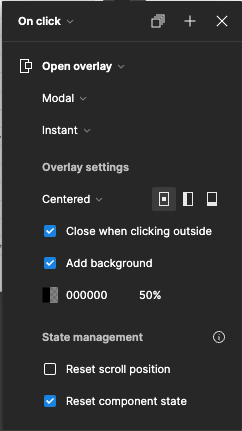

Apr 22, 2024 7:54 PM UTC
Posting for other people finding this post. At the first interaction, you can check the ‘Reset Component State’ checkbox. Example in the image below:
