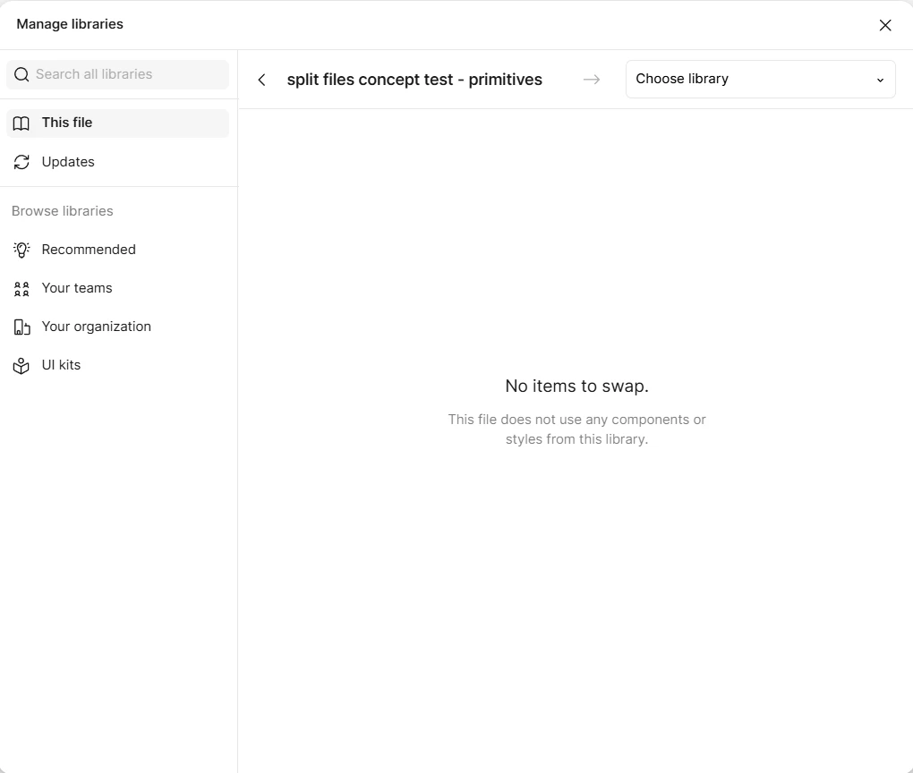

Thanks for getting back to me. I just had a look at the Swap Library feature. Unfortunately, by the look of it, it doesn’t support variables. Only components and styles:
