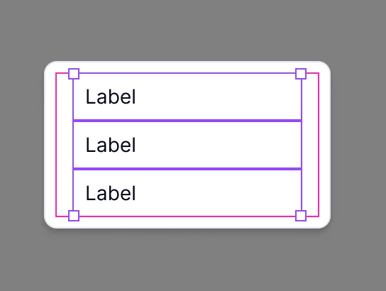

    erin.io
    Mar 17, 2026 5:45 PM UTC
    I’d also like to see an option to set the W or H fill rule for components added to slots. Currently, the user has to manually set the fill setting after adding slotted components. A fixed width dropdown menu is a good example. If each slotted component inside the Menu is a Menu Item, those all need to have their width manually set to “fill container” after being added to a slot, regardless of what the main component’s width setting is (and even then, the only way to set the parent to “fill container” is if it’s a variant within a component set who’s container is set to auto-layout, which is not always conducive to good component set organization).

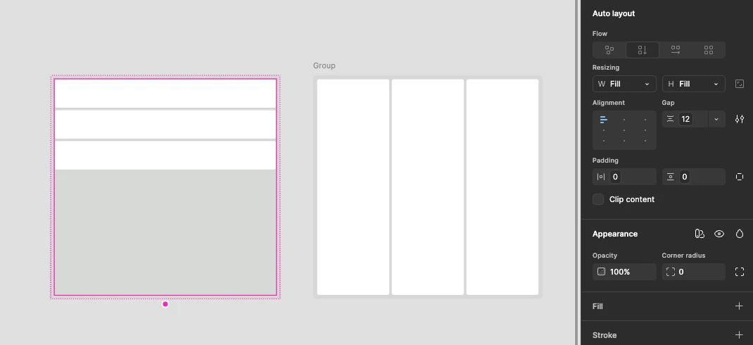

    Stein Olav Pettersen
    Apr 7, 2026 12:52 PM UTC
    In our design system we have got an AppLayout-component which is a nice starting point for our designers. The component contain different components like a header with app-logo, avatar, search field, etc. There is a left menu and a main content field on the right hand side.
    Most designers are simply detatching this component. With the new slot-feature I had been hoping for a better approach with less detatching but realized that it is not possible to override the flow direction in the autolayout in the slot without detatching as the flow direction is disabled (see the “main content field” example below)
    (With the public beta slot component I am still able to work around this issue but would be nice to have a better integration)
