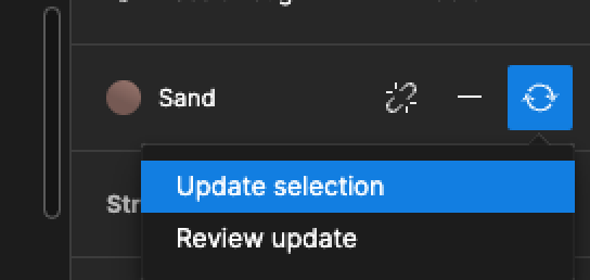

In the meantime, when you updated your master file, did you see the update icon as shown in the attached image?
Thanks!

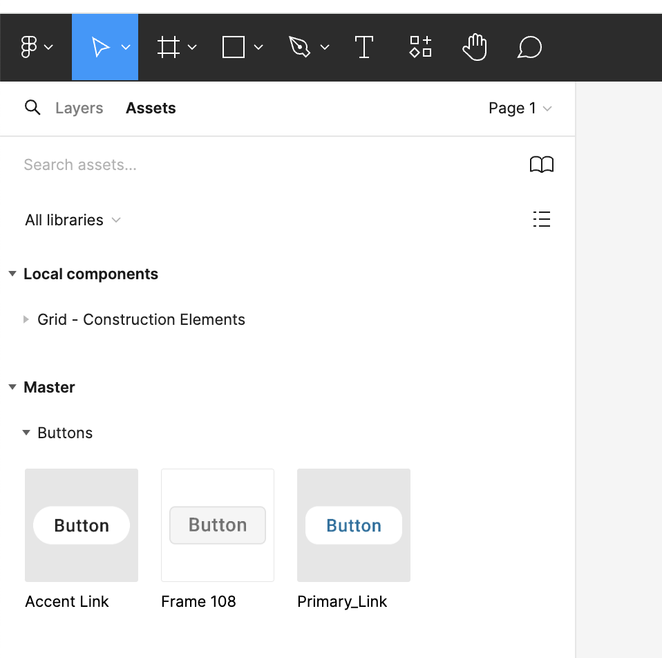

Sarah84Author
March 12, 2024
Thank you for your reply.
I don’t see that icon anywhere. I have attached an image.

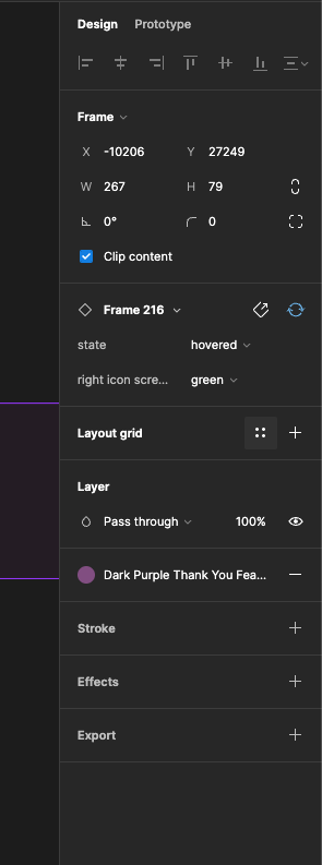

Thanks for the reply! It’s in the design panel -
Could you make check it?

Sarah84Author
March 13, 2024
I don’t have that button. Also, I need to update my file, not an instance.
