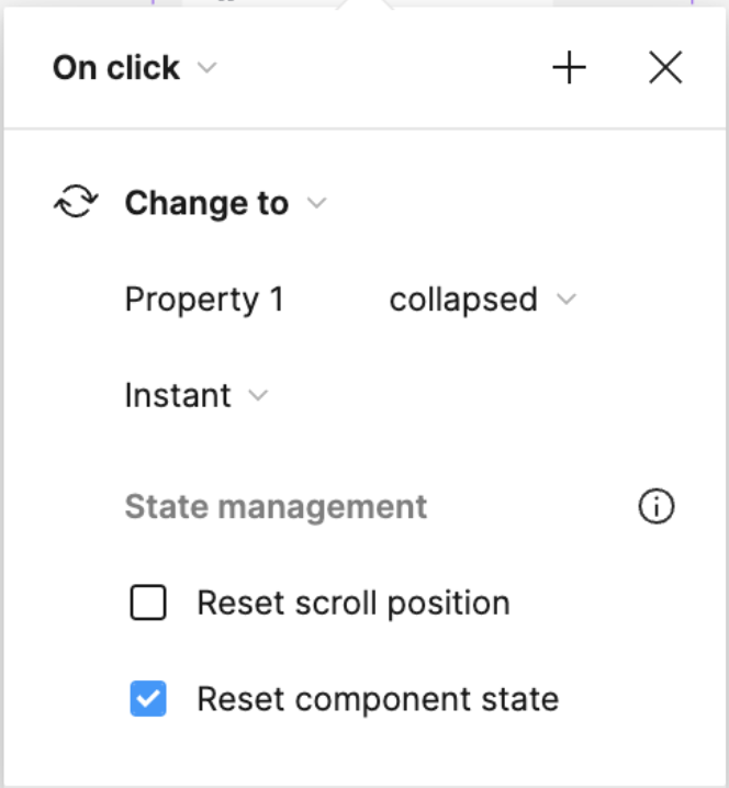

Hey @Daniel39 and @MiloW, thank you for reaching out! Apologies that we’ve not paid any attention to this post, happy to take a look at it!
Could you please check if you’ve checked “Reset component state”?
When navigating through prototypes, an object’s state may be reset on specific interactions.
  • Reset component state: Reset to original component state, as set on the canvas
More information on this you can find in out Help Center article: https://help.figma.com/hc/en-us/articles/14397859494295-State-management-for-prototypes#01H7KCNN3MQB5YR6CJP2TGMSZN
If this is not your case can you provide a direct link to the file here, and invite support-share@figma.com with “can edit” permission so we I can into this further? Note that users with @figma.com emails on your team do not count towards your billing.
