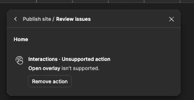

Hi mates,
I was using Figma Sites from a first date was release at Figma Beta. But I really don’t known how to prototype “Open Overlay” just like Figma Design was like. Any one known how to work-around with that.
I was copy my design with prototype work-fine from Figma Design, but still can't running with Figma Sites.
And when I publish, I receive this message “Interactions · Unsupported action"
Really annoying that they bring many new interactions, but somehow forget little trigger but useful like “Open Overlay"

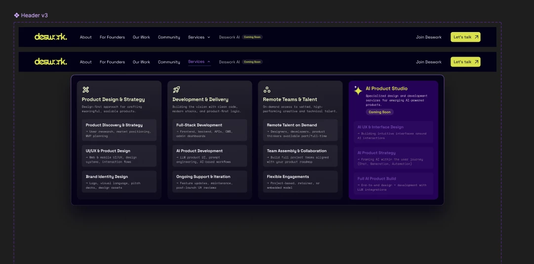

farhanshakir
Jul 20, 2025 9:39 PM UTC
Hey ​@Duong_Anh !
I was facing the same issue while trying to get overlays working in Figma Sites. Unfortunately, there’s currently no official support for the “Open Overlay” interaction like we have in regular Figma Design files.
What worked for me is a little hack:
I created two states of the component (for example, with and without the popup/dropdown) and used an “On Click → Change to” interaction between them. This way, it simulates the popup behavior. It’s not perfect, but it gets the job done for now.
You can see the attachment for a better idea.
Hopefully, Figma adds proper overlay support to Sites soon — seems like a pretty common need!
