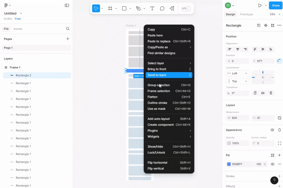

Prototype a sticky bar in Figma that appears after the user scrolls a certain percentage of the page
I’m looking to prototype a sticky bar in Figma that becomes visible once the user scrolls past x% of the page height. The animation should have a smooth slide-up effect to keep the experience seamless. Any ideas on how to achieve this in Figma’s prototyping mode?
For example, a sticky bar appears only when user scrolls to 20% of the page and it will become fixed to bottom of screen for the rest of the scroll depth. Then when a user scrolls back up, the element releases from the fixed position and disappear. You can see this in effect on this page
Does anyone have any solution to this?
Nellya
Power Member
Feb 13, 2025 8:20 AM UTC
You need to wrap your sticky element in a frame of the needed size. It will be sticky only inside it
