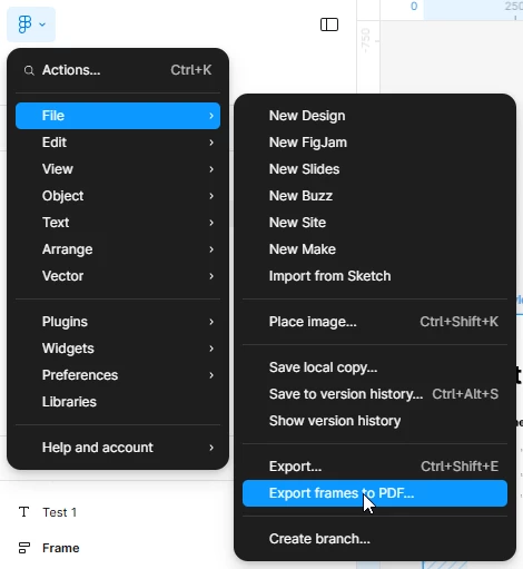

    You can export it here

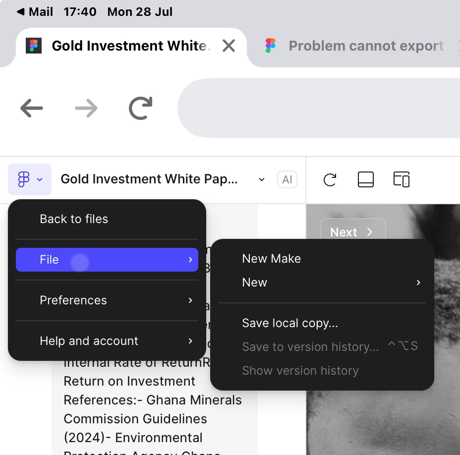

    I cannot see this explained menu all is see it this:
    Robina Latham
    Jul 28, 2025 4:42 PM UTC
    I’m working on the desktop using my iPad, i then tried it on my computer and still the menu is restricted and i paid £200 for the full subscription !

    It looks like you used Figma Make instead of Figma Design to create your document. I’m not sure there’s a way to export it to PDF from there. Perhaps someone else knows a way.
