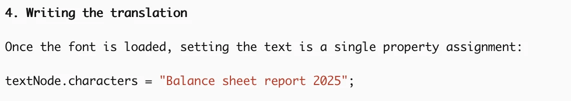

It overwrites in one shot yes. See part of the prompt in my screenshot. How could we make sure AI understand segments? I have two doubts:
- How can AI not embark the style from the first character only? (understand the notion of segments concretely without having to have each text style in a separate text layer)
- It’s not necessarily the same number of characters in French vs English or German for example. What if we have one word in bold in French and it should be two in German?
Thanks again for your help! Ludivine

Thanks for the screenshot, that's helpful. Let’s talk about why the styling disappears.
Looking at the docs, this is expected behavior rather than a bug, and your step 4 is the exact spot. Setting textNode.characters = "..." is documented to reset all styles applied to character ranges — so the moment that line runs, the bold/italic/color/bullet info is gone and everything collapses to a single style. That's also why it "embarks the style from the first character only": the flattened node takes the leading run's style and applies it to everything.
Based on my read of the dev docs here, it's the setter itself doing the flatten — not the AI misunderstanding the instruction.

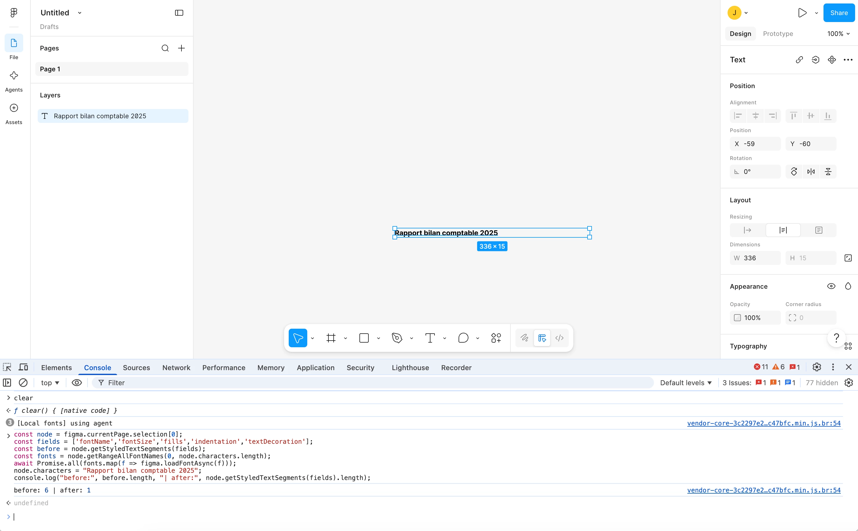

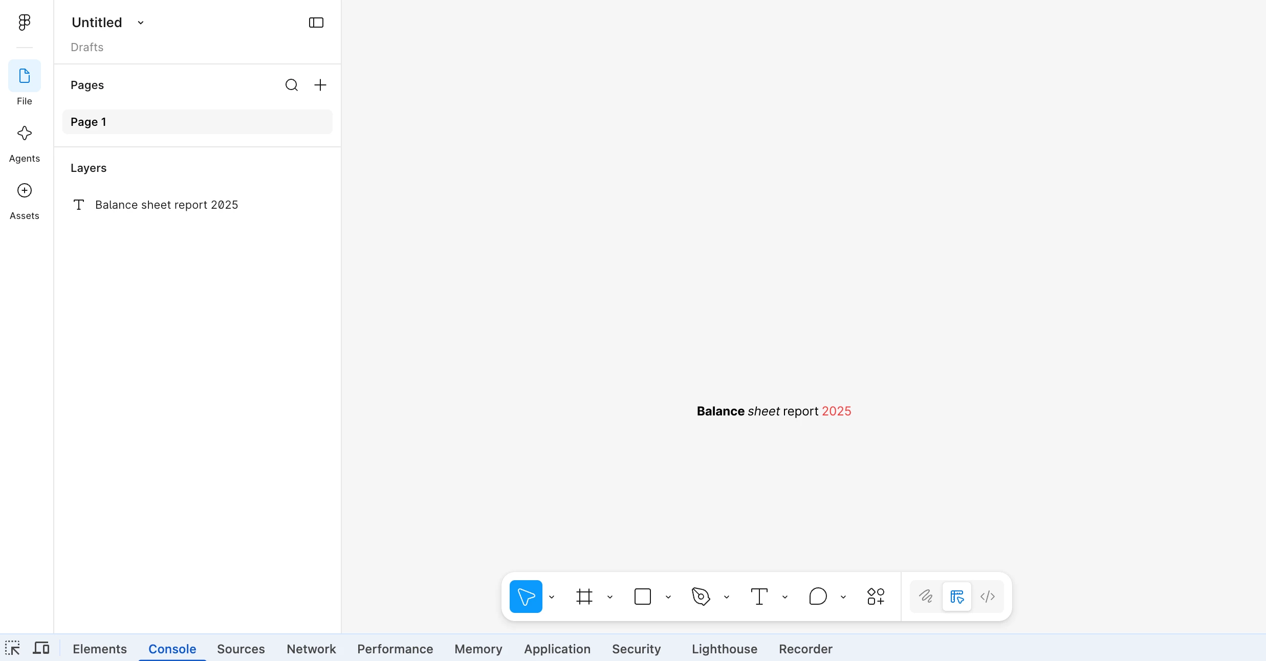

Here's a quick console repro if you want to see it directly (Plugins → Development → Show/Hide console). Make one text node with mixed styling — bold/italic/colour on different words — select it, then run:
const node = figma.currentPage.selection[0];
const fields = ['fontName','fontSize','fills','indentation','textDecoration'];
const before = node.getStyledTextSegments(fields);
const fonts = node.getRangeAllFontNames(0, node.characters.length);
await Promise.all(fonts.map(f => figma.loadFontAsync(f)));
node.characters = "Rapport bilan comptable 2025";
console.log("before:", before.length, "| after:", node.getStyledTextSegments(fields).length);
On my test: before: 5 | after: 1 — five styled segments collapse to one, the color drops entirely, and the whole string inherits the first word's bold.
Before
After
