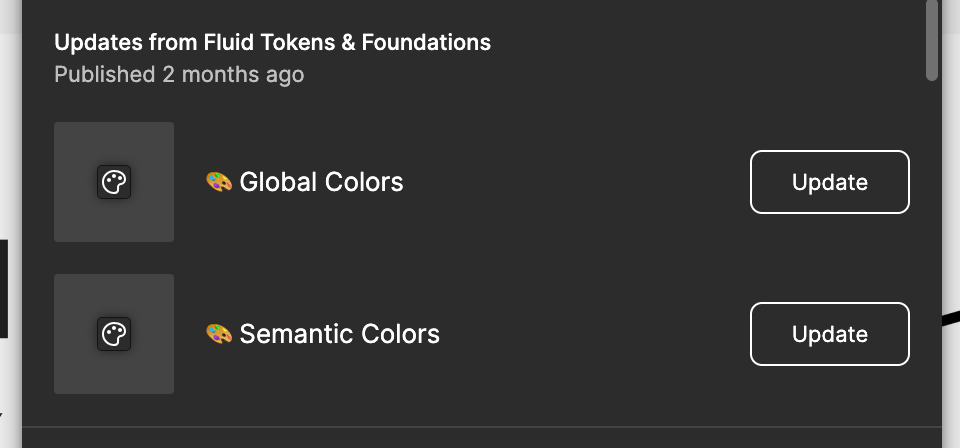

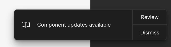

Hi everyone, we are maintaining a Design System and working with Variables/Tokens. Even without updating the variables the ‘Components update available’ dialog keeps on coming up :
Would you know why or how to fix it?

I am indeed experiencing an issue where the notification keeps showing up on the same file after review and accept the updates. It seems that it always shows a Variable update when there is actually nothing to update.
This occurs on the desktop app, and to be frank I don’t use the browser version often enough to confirm that it happens on it too.
I cleared my cache, but this does not only happen to me, it happens to other editors of the files.
