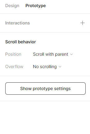

Set the height of the frame “overlay” to the height of the frame “Website” and from Prototype panel for the frame “overlay” set the overflow to Vertical

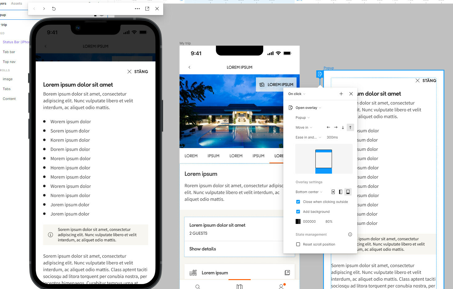

Thanks, but that’s still not working properly. I can get the overlay to scroll how I want with the overflow set to Vertical, however when I do this, I have to “fake” the spacing at the top or else my pop up ends up with 0px margin top when it opens as overlay, and I cannot control the bottom margin so the pop up ends up with 0px margin at the bottom.
The overlay is also not showing the darker background (#000000 80%) overlaying the underlying content like it should, even though I’ve defined this for the overlay.
I’ve updated my linked file with the described example. Would greatly appreciate if you have a look and can tell me what I’m doing wrong.

I copied your file to my space and made those adjustment:
  • Removed the parent frame “overlay” containing the popup,
  • Changed the popup height to ((844 - 120), you can add any value here to create the top space gap),
  • Changed the width to 390; and
  • Changed the overlay settings to Bottom center.
** you might change the instant animation to move in - from bottom, that would give it a nice feel.
and the issue with the background was that your popup parent frame already filled the screen so there was no background to show.
P.S from the position option you can set a custom position for the popup.
here is a link for the file https://www.figma.com/file/q81PScyPOc3tACI4fu8Itq/Overlay-(Copy)?type=design&node-id=13%3A128&mode=design&t=ZUJqo0f6j90JGoj4-1

Thank you for this, unfortunately it’s still not doing what I want it to. I don’t want the content to scroll inside the pop up/overlay, I want the whole overlay frame to scroll over the underlaying content, including the overlay’s white background.

Thank you, I really appreciate all your help with this but it’s still not what I’m trying to achieve. If you check my file again I’ve updated it and followed your steps, to achieve the same result but what I want is for the entire white area to scroll over the content. I’m struggling to find a good way to explain what I mean here but if you check my file again and play the prototype, you see how the text is scrolling inside the white background, that’s not what I want, I want the whole frame (background + text) to scroll over the underlaying content. Does that make sense?
