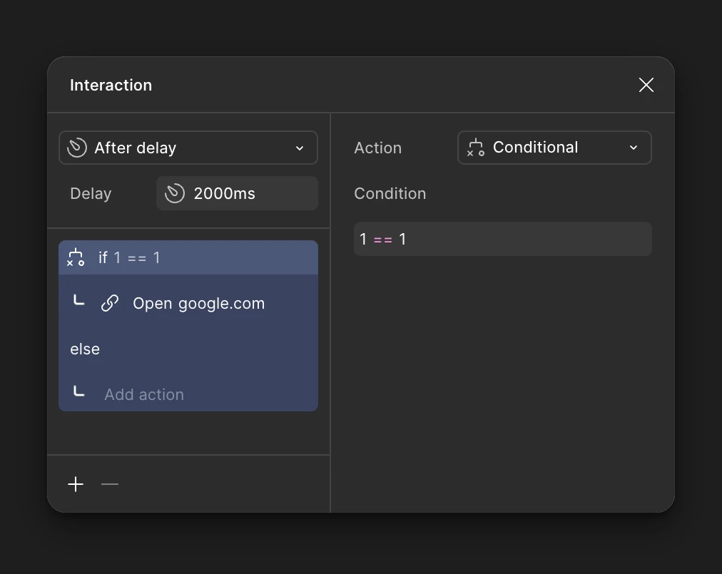

With your help, we’ll be able to add more context to the existing bug report. To be transparent, this is now a long-standing bug, so it may take some time for them to resolve. From our initial investigation, we discovered that there are some limitations that prevent “Open link” from working well in conjunction with the “On delay” trigger.
As a temporary solution, you can wrap the “Open link” action in an always-true if statement that triggers after a delay.
We apologize for the inconvenience in the interim and appreciate your patience while the team works to make changes.
