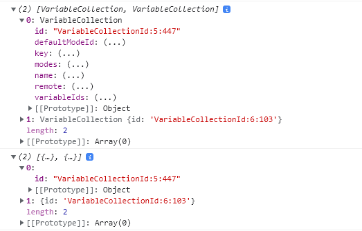

For some reason, when I send the prop through, some keys gets removed. What is causing this?
Below is an image of how it looks like before and after

As you can see, all property values, except for id, have not been evaluated and are displayed in the console as (…). Therefore, you need to create a copy of objects with already evaluated values, and only then send this copy to the UI. You can get these values by calling the getters of the required properties.
