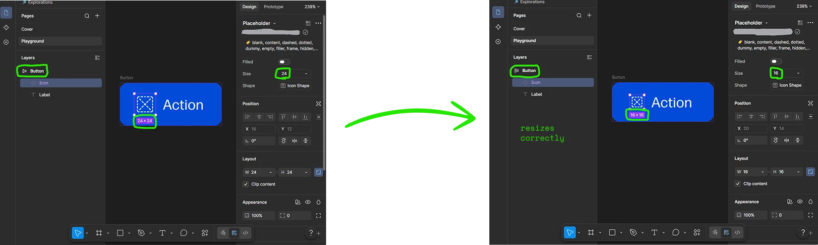

Because the instance stays 24x24 and the source vector is set to Scale/Scale, the 16px vector artificially expands to fill the 24px space. It completely breaks the sizing. Here’s a screenshot:
You can see that the icon instance size remains at 24px despite changing it to the 16px variant.

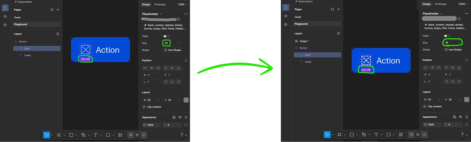

The Weird Part / Troubleshooting If I take that exact same Button instance, detach it, and then change the icon variant to 16px, it resizes perfectly. The frame snaps to 16x16 and the vector renders exactly as it should. Here’s a screenshot:
When the button instance is detached, the icon instance is able to resize based on which size variant is chosen.
