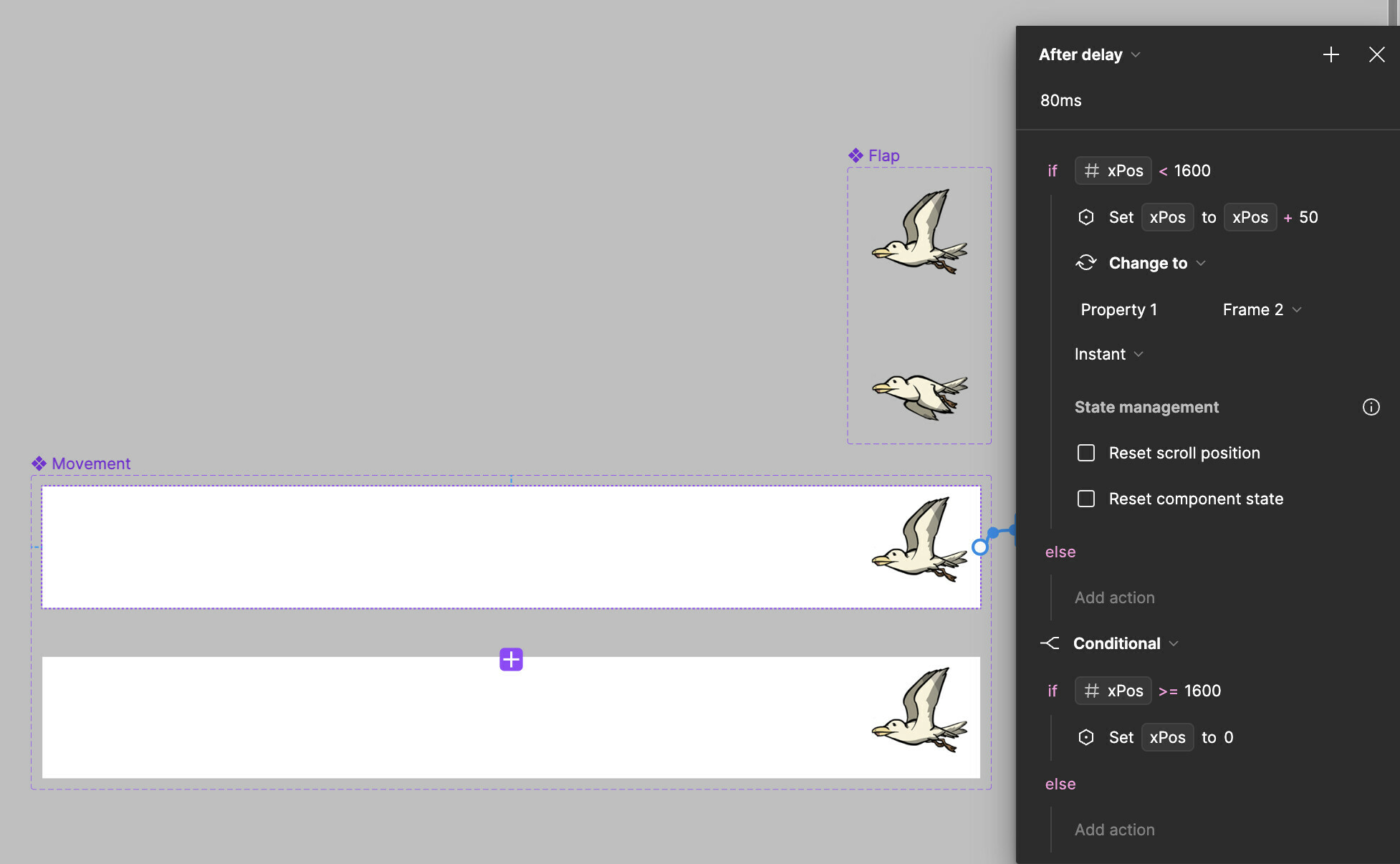

Vishal_Ramawat
May 22, 2024
Yes, I had similar issue while trying to make a flapping bird move across the screen.
The only way I could get it done was using a variable to change the padding of the bird so as to simulate movement.
Another thing to note is, the After Delay in swapping Movement variants (80ms) should be more than After Delay in Child variant swapping (75ms)
Hope this will help you in figuring out a solution for your use case.
