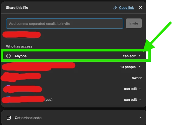

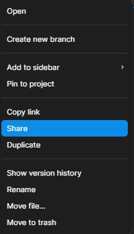

Do it here (right mouse button click on the project file in Figma), click “Share”

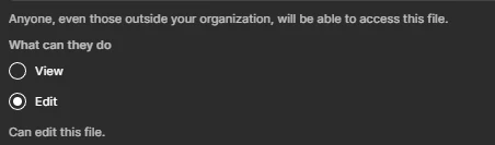

  and then click the “Anyone” row. And click the “Edit” option
