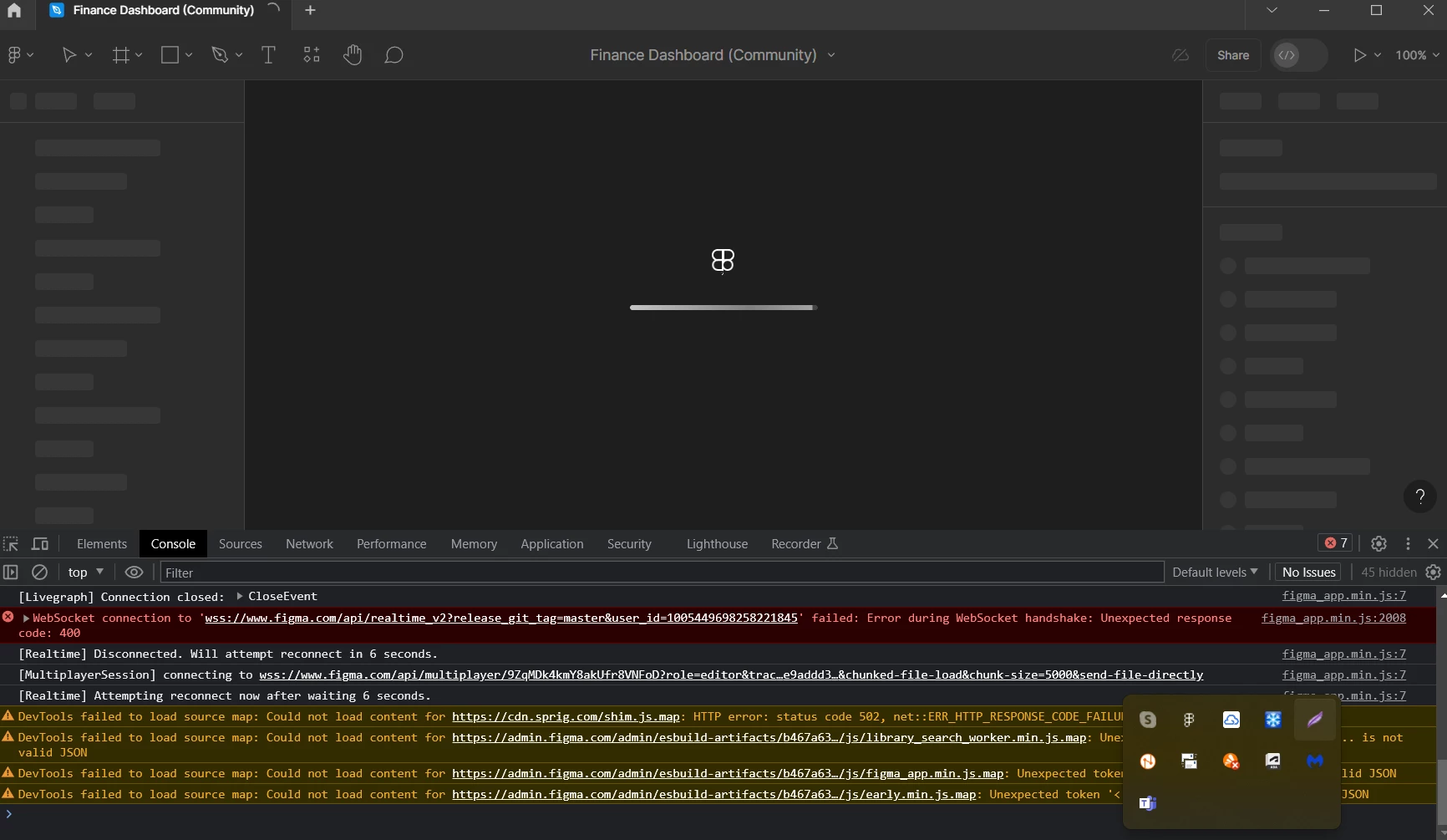

Hi @Charles_Rio, thank you for reaching out and sharing your console log with us!
It looks like your network has WebSockets blocked, preventing you from using Figma. Please go to https://websocketstest.com/ and check the results.
  • If WebSockets are showing as not supported, please ask your IT Administrator to configure your network settings to allow WebSockets.
  • If WebSockets are showing as supported, please let me know and save a screenshot I can create a support ticket on your behalf so that our team can continue to troubleshoot based on the results you see.
Please let me know what you’re seeing WebSockets as supported or not supported.
Thank you in advance!
