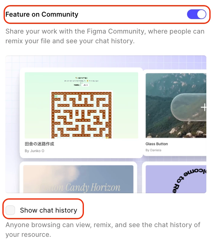

    If you don’t mind publishing to the Figma Community in addition to your focus group, please try publishing with the following settings:
    • Turning on the “Feature on Community” toggle
    • Uncheck “show chat history” if you prefer not showing the chat history
