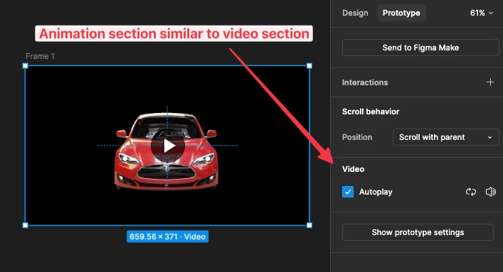

It would be great to have an Animation section with options to control autoplay and loop for  selected animated elements, like the section we have for video.
