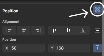

Missing Fill container option
  • September 27, 2025
  • 99 views
Can you please help me understand why “fill container” is not an option for the selected layer? I’ve looked through all similar topics and they don’t seem applicable. Attached SS of parent and child layers…

You need to turn off Ignore auto layout option
