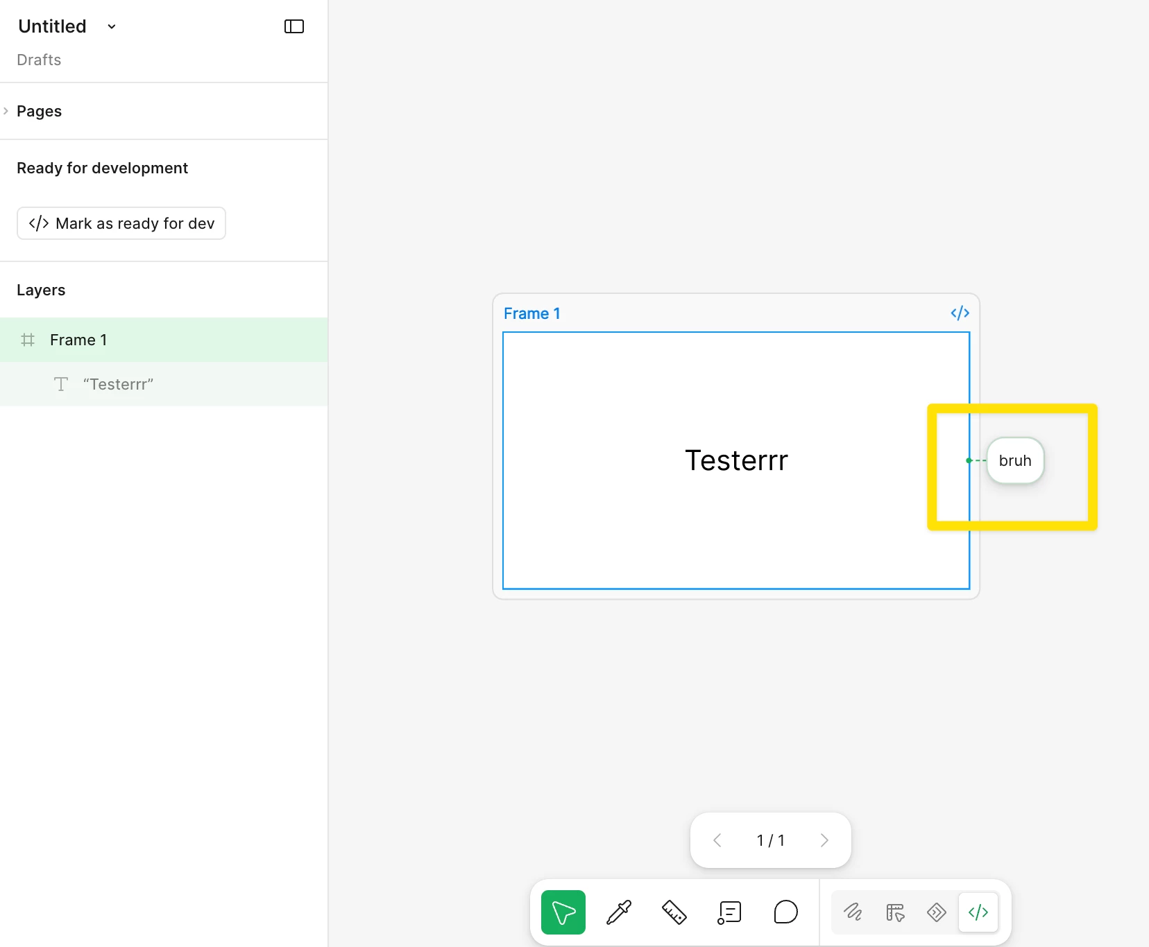

 Good news ​@KBW I was able to get it working using a simple test. I used Claude Code (YMMV):
  • In a Figma Design file, add an annotation — I chose “Bruh” 😎 (Dev Mode > annotation tool) to one specific layer. Note that layer
  • Copy that layer's link: right-click the layer → Copy link to selection. This gives a URL with node-id in colon form
  • In Claude Code, prompt:
    Call get_design_context on this node and show me the full raw response, including any annotation data: <paste node URL>
Output:
Generated Code:
export default function Frame1() {
return (
<div className="bg-white relative size-full" data-node-id="1:3"
data-annotations="bruh">
<p className="[word-break:break-word] absolute font-['Inter:Regular']
font-normal leading-[normal] left-[206px] not-italic text-[32px] text-black
top-[126px] whitespace-nowrap" data-node-id="1:4">
Testerrr
</p>
</div>
Annotation data found:
The root <div> (node 1:3) has:
I hope that helps getting you moving forward! — Jaycee
