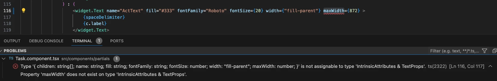

I see this specific version (Version 1, Update 69 | Plugin API) has a change I want to use - maxWidth on Text or AutoLayout. However, I can’t find a way to update my plugin to this version so that I can use this style property. Any suggestions?
I’ve tried implementing (multiple ways) in my current code and keep getting the error “Property does not exist in IntrinsicAttributes & AutoLayoutProps”.
Any ideas/advice?

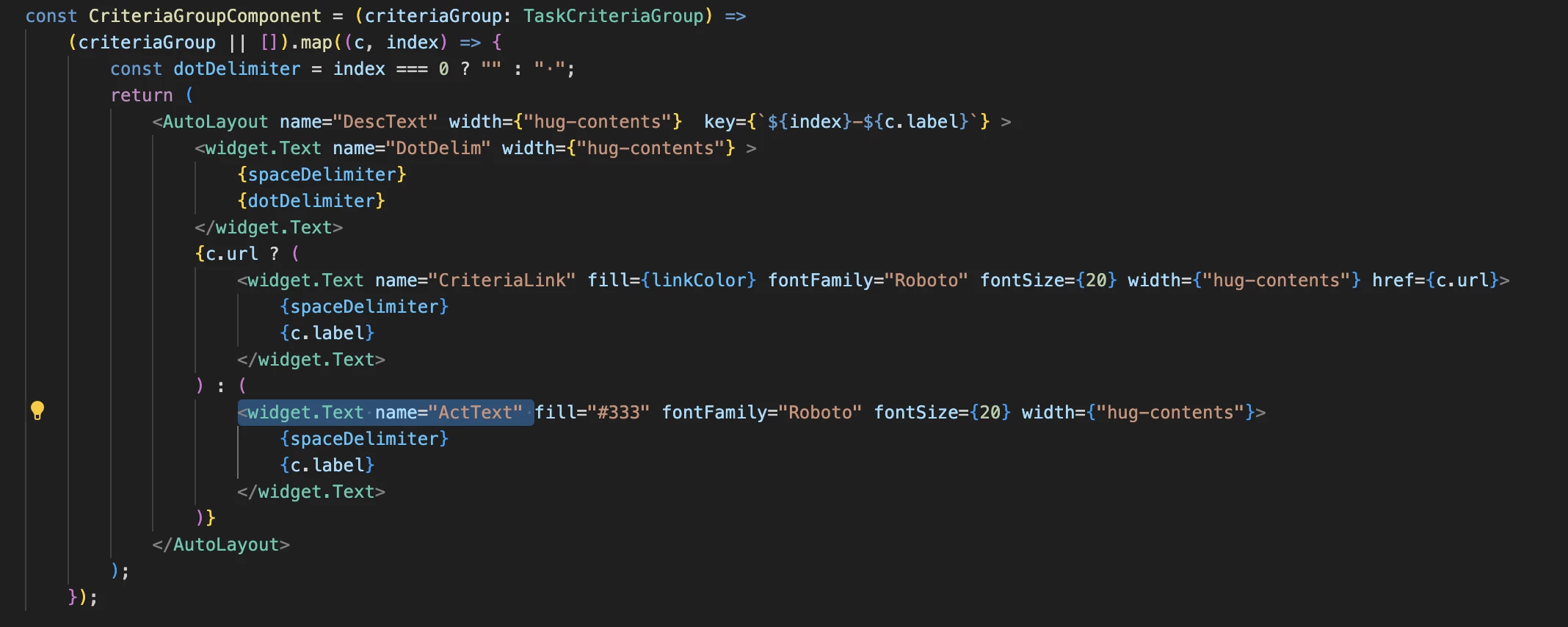

I’m seeing the error in my IDE.
I’ve tried adding the maxWidth to:
  • Autolayout (various levels of frames and nesting - top to bottom)
  • Text w/in an Autolayout
I’d like to have the maxWidth applied to that widget.Text name=“ActText” in conjunction with the width={“hug-contents”}, which I can do in Figma itself, but seem unable to translate to the code.
Samantha_Fraser
September 20, 2023
The error
