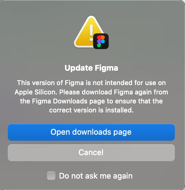

    Vladyslav Hryhorenko
    Apr 30, 2025 6:56 PM UTC
    This version of Figma is not intended for use on Apple Silicon. Please download Figma again from the Figma Downloads page to ensure that the correct version is installed.
    tank666
    tank666Solution
    May 1, 2025 12:53 PM UTC
    https://desktop.figma.com/mac-universal/build/Figma-125.4.6.dmg
    Please tell me, do you have a link so that I can always download the latest version?
    Or will I have to request it every time?
    You can get the latest version of the app using the installer available at the following link: https://desktop.figma.com/mac-installer/Figma.dmg
    Or direct links to archives:
    https://desktop.figma.com/mac/Figma.zip
    https://desktop.figma.com/mac-arm/Figma.zip
    As for the specific version, just change the build number in the links mentioned above.
