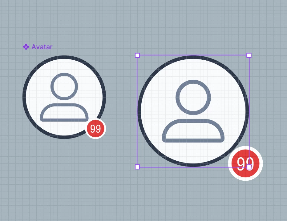

KennLucas
November 7, 2025
Thanks to @seni for reopening this!
There is absolutely no reason that basic functionality like this is not being addressed!
The word “constraints” is a thing. This is a key performance issue that I have been complaining about for years. Last night this came to a head as I am on a deadline and cannot build a component to function as it should.
With the advances in variables in the last year, this is crucial as it basically fights with the way Figma SAYS it is supposed to work.
In an avatar component, we have a status dot constrained to bottom right. HOWEVER with variables, we can create a collection to allow for resizing of the instance without having to create variants. HOWEVER, Figma does not follow its own rules on constraints.
When I resize a containing frame, the constrained object (bottom right) should stay where it is told to stay. Not break out of the frame or reposition. Ignoring the set constraints.
This is most definitely a bug. But not reported here as a bug in the forum. @seni , maybe we can move this over to a bug report?
