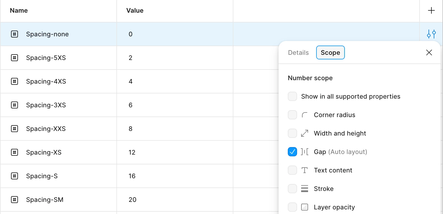

Hey, yea there is actually a a better way to apply tokens! First of all you should set a scope for your variables. In the variables window you can set the desired scope for each variable like so:
After that you can also use plugins like https://www.figma.com/community/plugin/1328087147232215180/match-variables to apply your variables on a whole frame or selection.
