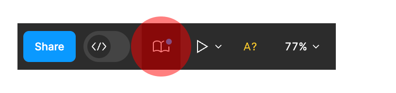

There is a button at the top right of Figma that allows you to manage updates from the library across the file.
Once pressed, it will open a modal where you’ll be able to choose what to update and what not to update.
Hope it helped
May 3, 2024
Hi @Haroll ! I can’t see that icon in my topbar. Is there a short cut key opiton I can try to access it?
May 3, 2024
@Haroll I can see it in another project where the design system with all my main components are located in the same file as my prototypes. But where I’m running into the issue is where the main components are located in a separeate Figma file than my prototypes.

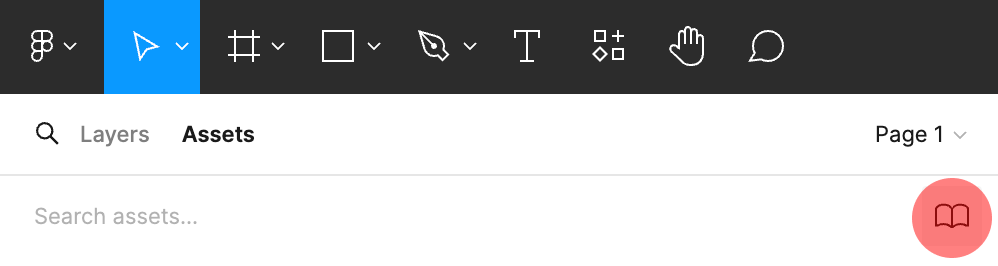

Shortcut would be +3for macOS or Alt+3 in Windows
You might also be able to access it on the left panel in Assets tab

Thanks a million @Haroll . The shortcut fixed it for me! 😃
