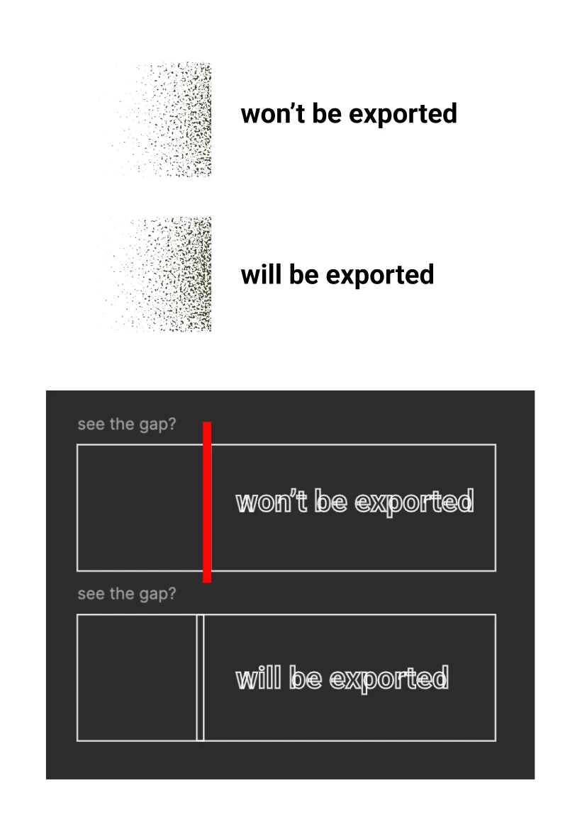

Only 250 views made me skeptical that this can be real thing. I discovered what is causing the problem. The problem only occurs with clipping masks. Figma ignores objects with effects that are outside the boundaries of a clipping mask.
For everyone facing this issue: Make sure the object with effects inside a clipping mask is taking up at least 1px inside the clipping masks boundary box. Bounding box and object with effect must overlap!
For Figma dev team: Please export it regardless of “completely outside bounding box”, it’s an intentional design decision if the spread is big.
