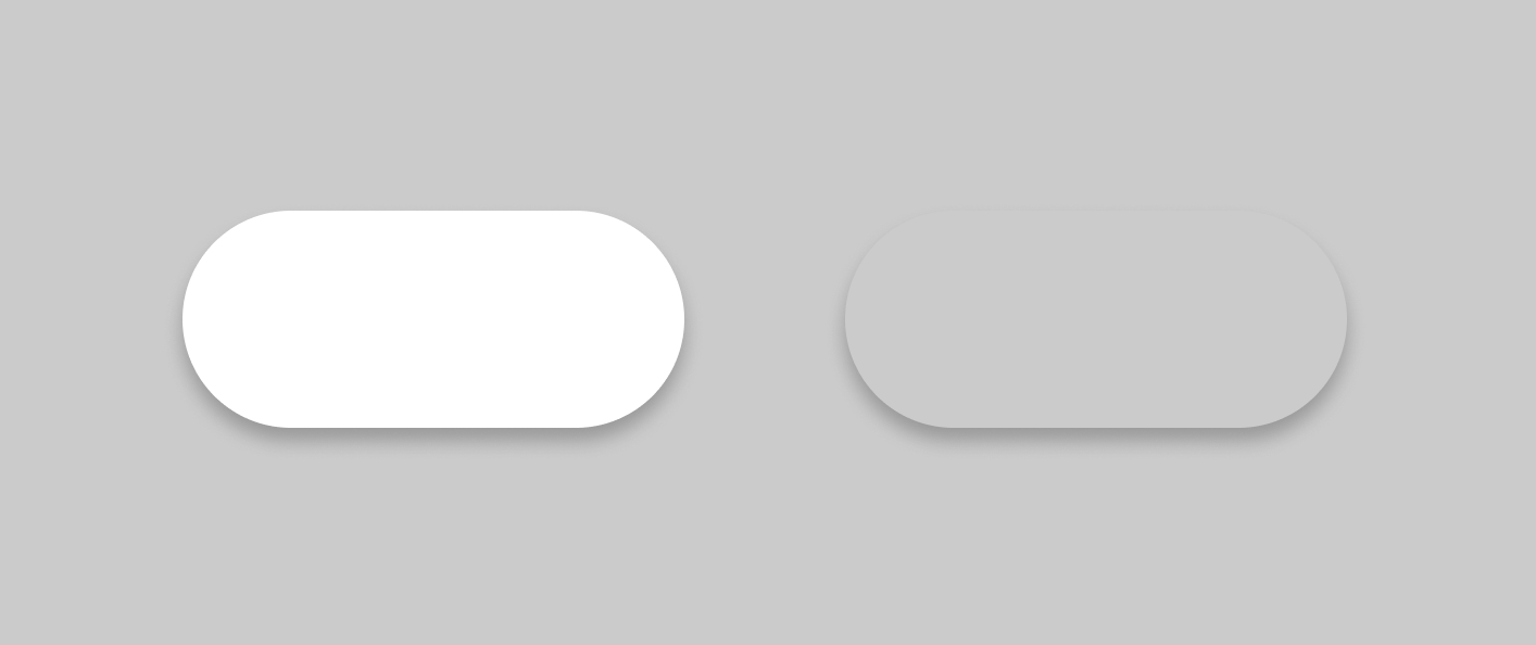

Is it possible to keep only the shadow of the shape?
If i adjust the Fill to 0%, the shadow disappeared.
Photoshop can do this:

You can either set fill opacity to 0.01% or use a mask to cut out the fill.

It seems that it doesn’t work anymore 😦
It works only at 0.2% in my figma

I can confirm, this is weird behavior on part of Figma. Photoshop can do it… but in Figma, we have to enter a 0.01 value in our fill to keep the shape active. Can’t this be changed to have shaped with ZERO fill, but still have their shadows?

Strange, this behavior of no drop-shadow with empty fill seems like something they would have had to code in. Maybe some dev thought too physically and felt overly clever that day.

I know its been years late to reply lmao 😆. but here’s my tip
First you need to set the blending mode of the shape to Multiply
Make sure that you are using absolute white to that shape (#FFFFFF)
and voila
