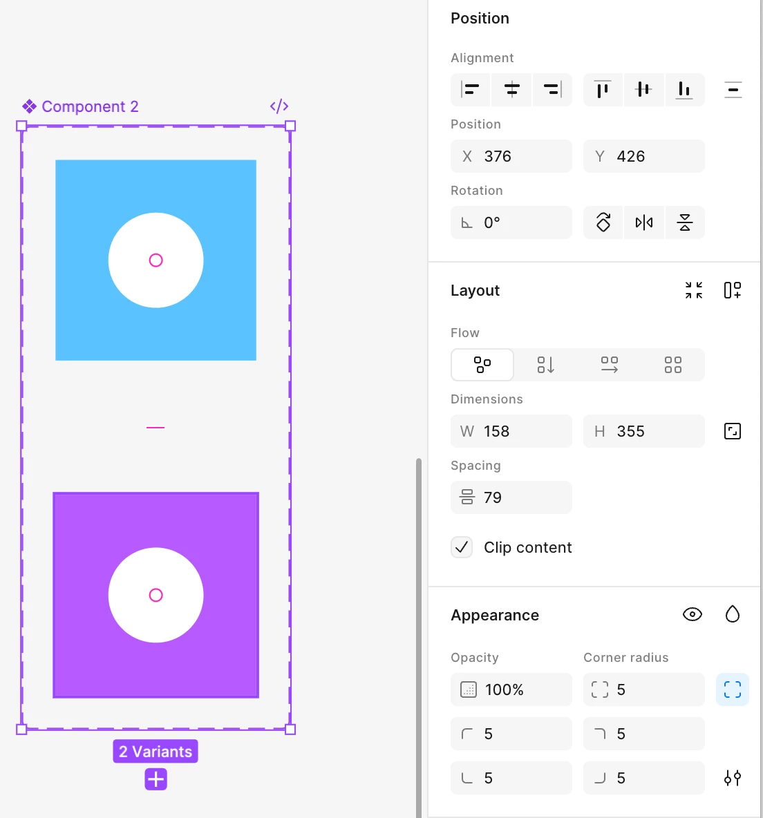

    loasfq
    loasfqAuthor
    Sep 5, 2025 4:42 AM UTC
    I’m not using auto layout but its not allowing me to add hug to the component set
    Perhaps there’s something wrong in the way i am setting it up…
    At the moment my process is:
    1. Create 2 white ellipses, turn them into, components.
    2. Reduce size of ellipses to fit better
    3. Copy and paste components, creating instances.
    4. Turn instances into component set.
    5. Try to set hug. Won’t let me XD
    There is no dropdown arrow to change from fixed to hug :(
    Gleb
    Power Member
    Sep 5, 2025 4:46 AM UTC
    There should be NO auto layout and NO hug. See my file. There is no auto layout and no hug anywhere. Hug is a property of auto layout so no auto layout implies no hug by default.

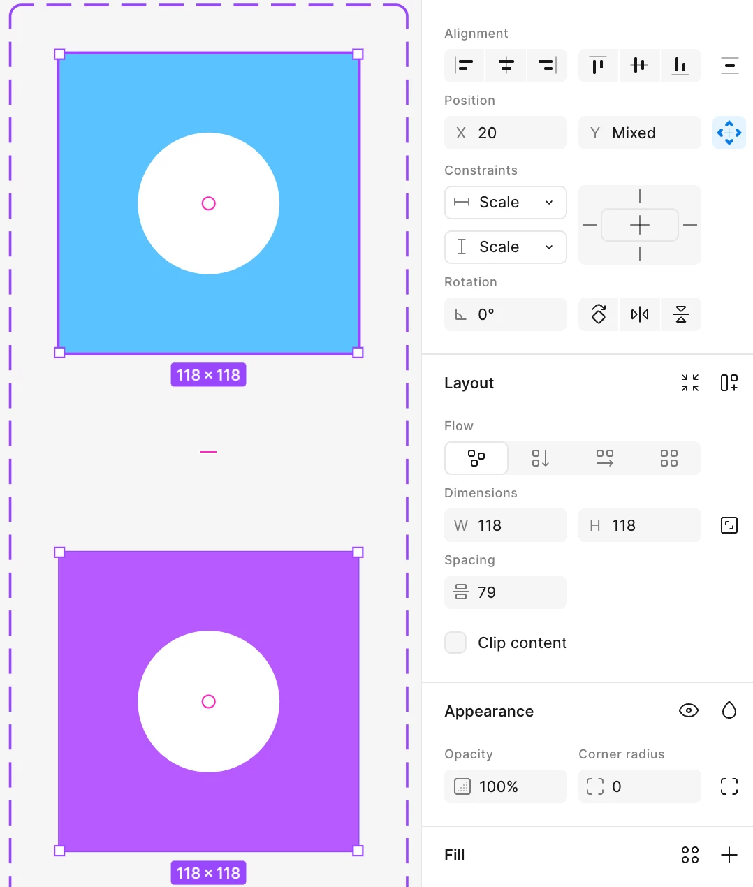

    Gleb
    GlebSolution
    Power Member
    Sep 5, 2025 5:00 AM UTC
    Everything is working properly now. Just set constraints to “scale” so the circle resizes relative to the parent. Currently it’s set to center so it won’t resize when its container changes.

    Gleb
    Power Member
    Sep 5, 2025 5:11 AM UTC
    See the circle that I selected on the screenshot I shared. That’s the one you need to change constraints on.
