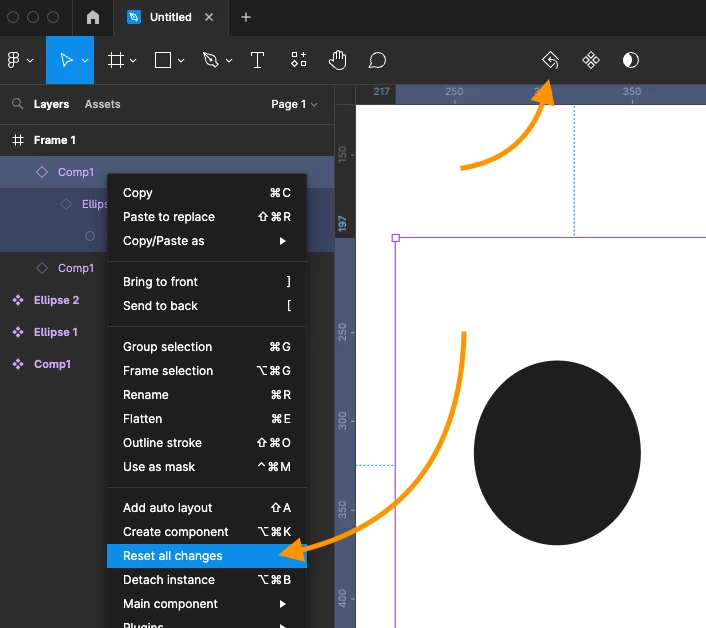

Related to it, the Figma UI shows the option to “Reset all changes” when right clicking an instance that has edits (a “Reset all changes” icon button is also shown in the top bar). It seems to become active when the instance has any edit (like an isDirty/isEdited state), which is exactly what I’d like to know in the plugin. Is there any property that exposes this?
