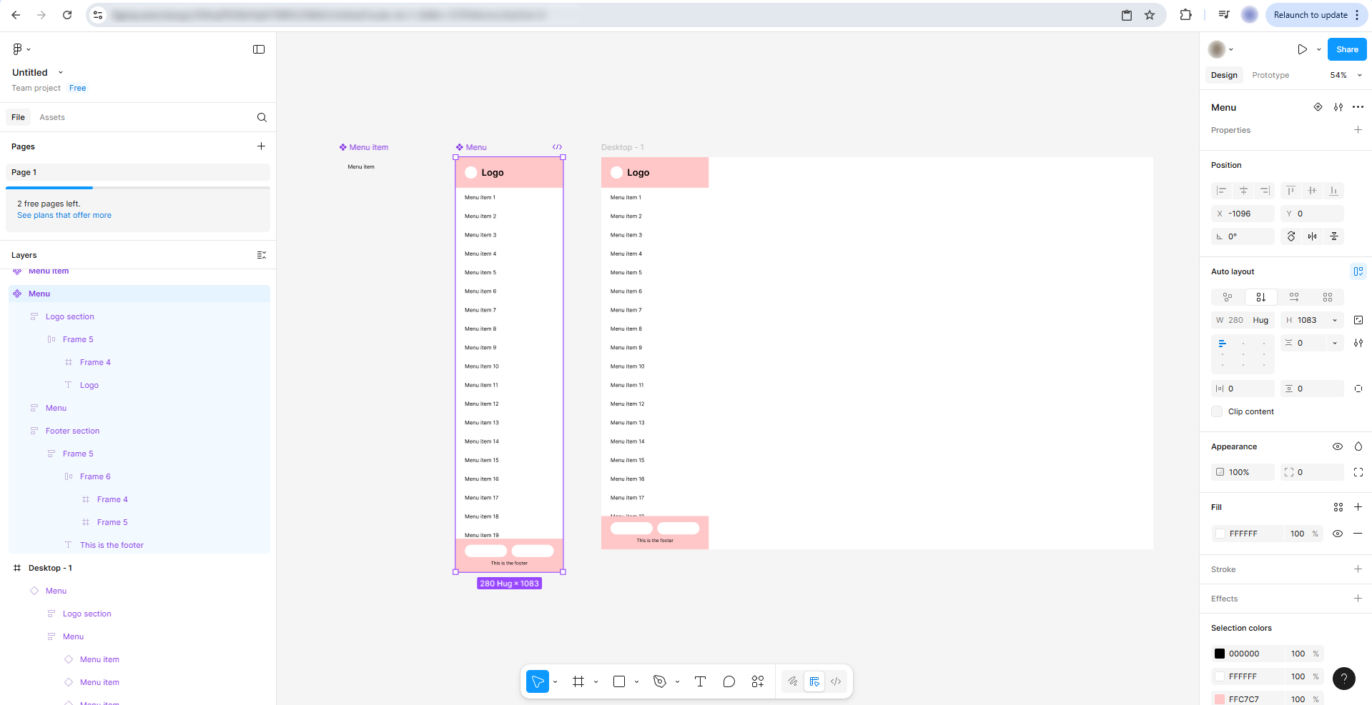

I am attaching a screengrab of how the side panel currently looks - apparently, the footer shows up after a certain scrolls of the menu items section. It scrolls within the menu items frame up to the 20th item without showing the footer, then scrolls the side panel to show the remaining items along with the footer. I am clueless about the behavior & the solution to fix it.
Thanks in advance for all the help!
  1. Image showing frames in the Menu component
  2. Video showing behavior of the side panel

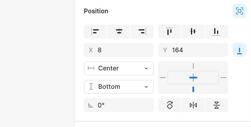

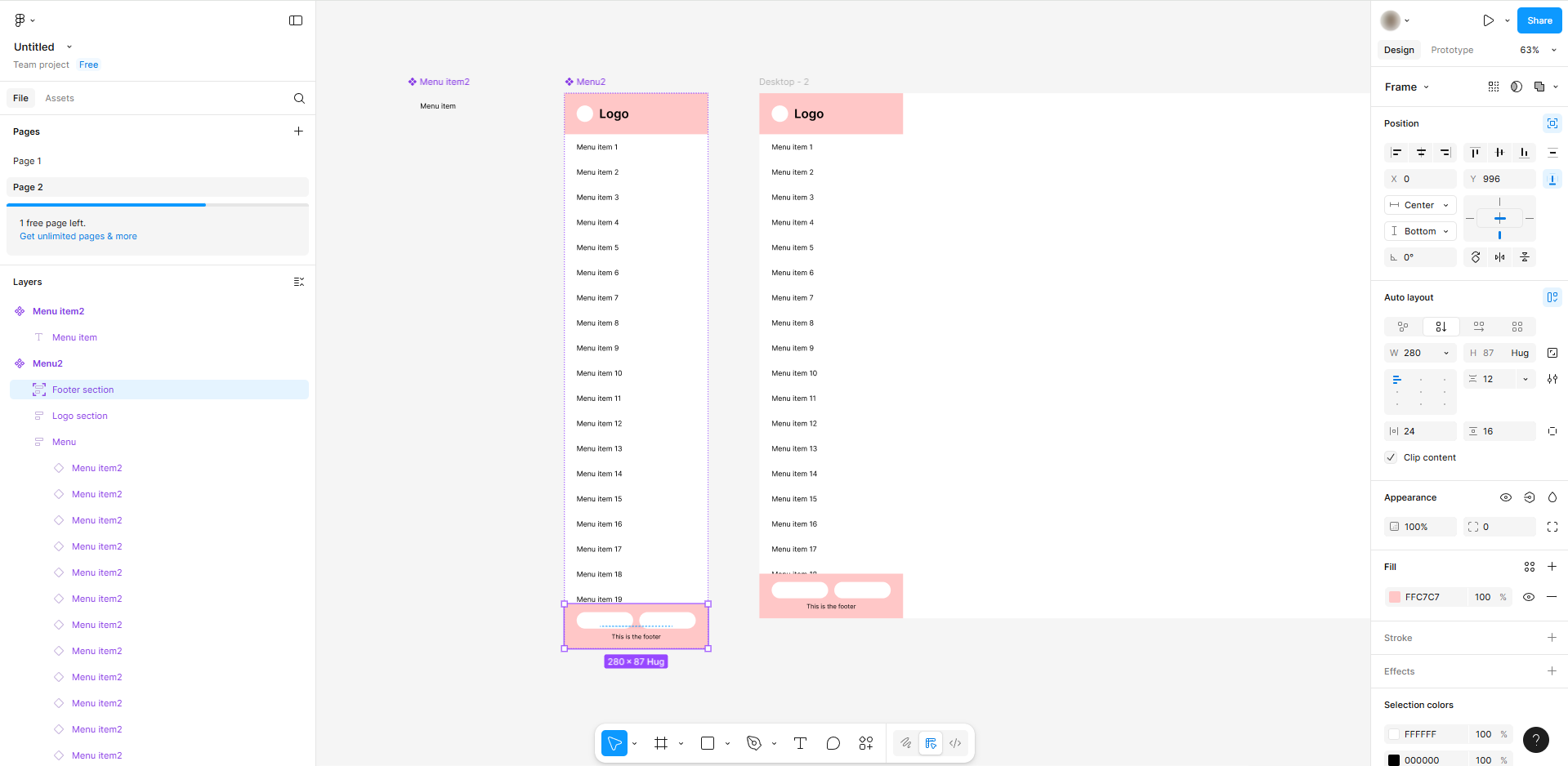

Jun 8, 2025 1:22 PM UTC
Hi ​@giliard thank you for the prompt response!
Yes, I was using ‘Sticky’ scroll option for the position of the footer frame.
But I changed it to absolute & my problem persists with the footer not showing unless I scroll down to a certain number of menu items.
Moreover, now I’m unable to scroll and see the entire list of menu items (there are 22, but I am able to scroll only up to the 20th)
  1. Image showing the new properties for the footer frame
  2. Screengrab of the new behavior on scrolling
