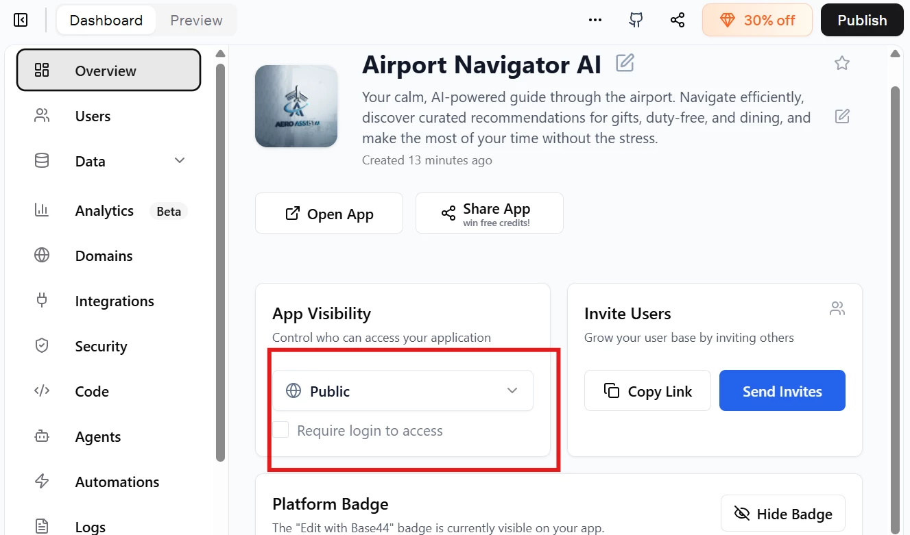

    1) Publish the website/application built in base44. But make sure to remove the checkbox for require login to access feature.
    2) Copy the published link.

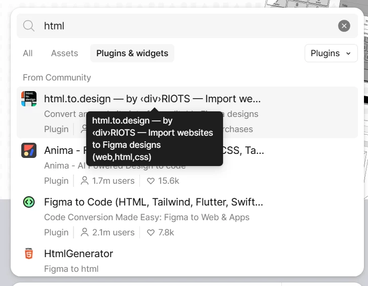

    3) Go to figma > Plugins > Html to Design plugin.
    There you go!!
