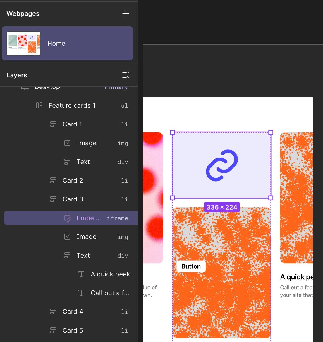

As an example, I added a Feature Cards block to my design, then added an Embed block below that on the canvas. Then on the Layers panel, I dragged the embed block layer up into a position as a child layer of one of the cards:
You can see how I dragged the Embed layer underneath the Card 3 layer.
