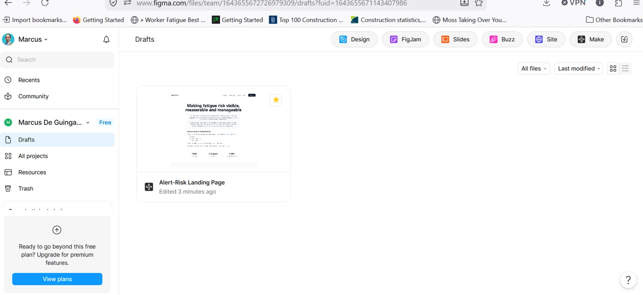

    MarcusdeG
    MarcusdeGAuthor
    June 3, 2026
    Follow UP - this is the screenshot of when I go back to files with the file as an AI version (icon bottom left). Marcus
    June 4, 2026
    Hey again, thanks for the screenshots, really helpful!
    I can confirm that your file was created in Figma Make, which is why you're only seeing the Figma Make interface. Figma Make and Figma Design are separate products. Unfortunately, it's not currently possible to directly convert a Figma Make file into a Figma Design file. More information on this article.
    It may also help to clarify the difference:
    • Figma Make is used to generate and iterate on functional prototypes and web apps using AI prompts.
    • Figma Design is the traditional design editor, where you can manually edit layers, frames, text, images, and layouts.
    That said, if you'd like to continue working in the Figma Design file, the recommended approach is to use the Copy design feature that allows you to copy the current state of your Make preview as editable layers and paste them into a Figma Design file. (In the preview of your app, navigate to the view you'd like to copy, then follow the instructions in Copy a Figma Make preview as design layers.)
    Please note this feature requires a paid plan with a Full seat, you can find more details on upgrading here.
    Since you're on the Starter (free) plan, the best option to continue for free would be to create a new Design file directly from your Drafts and rebuild your mockup there using the standard design tools (you'll have full access to those without needing any credits or a paid plan.)
    You can find more details here:
    Hope this clarifies! 🙏
