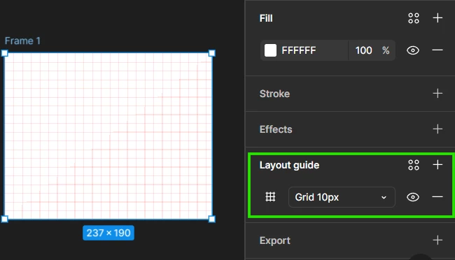

I can't find my layout grid in my properties panel
I just downloaded Figma to learn UI UX design i wanted make grid but i can’t find it in my properties panel and I have watched others but they have it there already. Can someone help me ASAP please.

Hi there,
I think you might be looking for the Layout guide section. It used to be called Layout grid, but Figma renamed it in a recent update. You can find it just below the Effects section in the right-hand panel, like in your screenshot.
Layout guide
Hope that helps!
