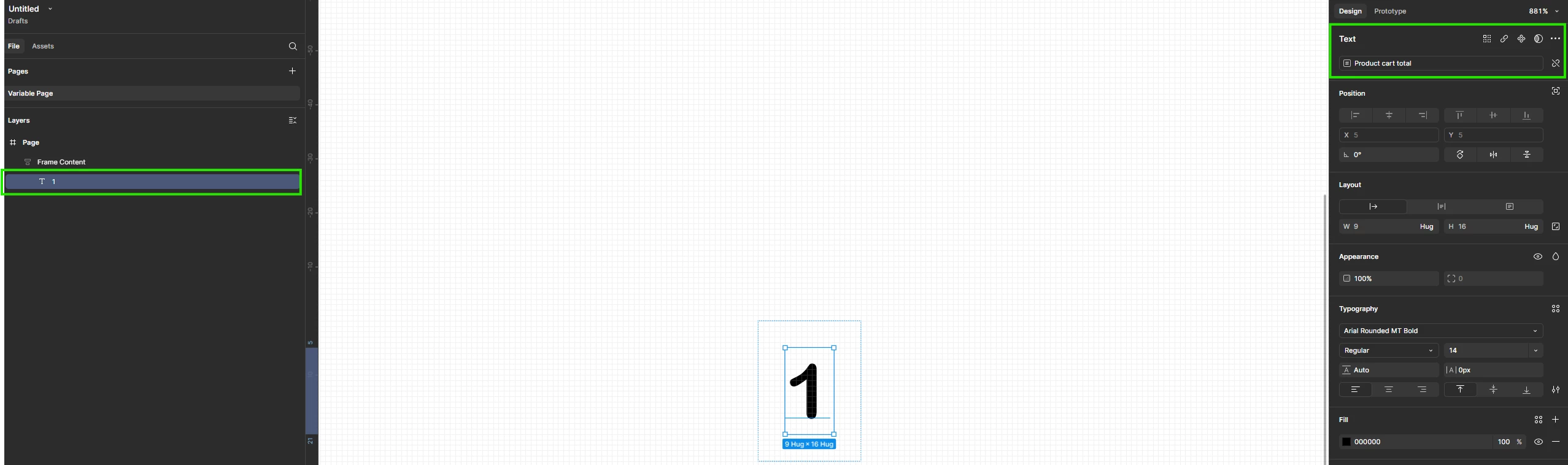

I can't attach my variable to my text

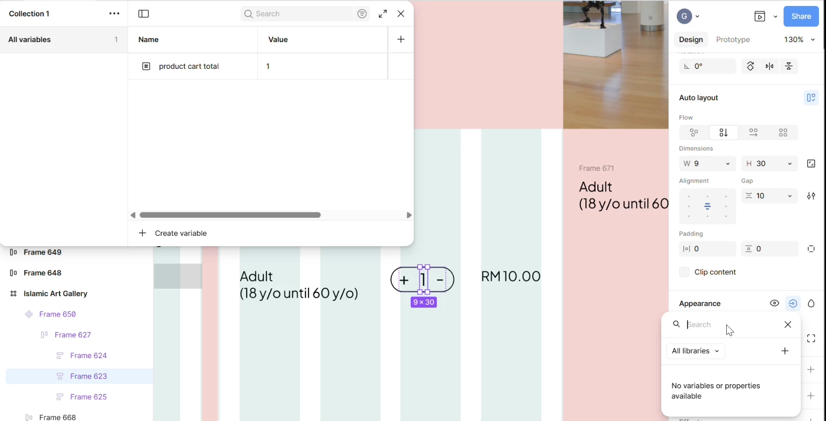

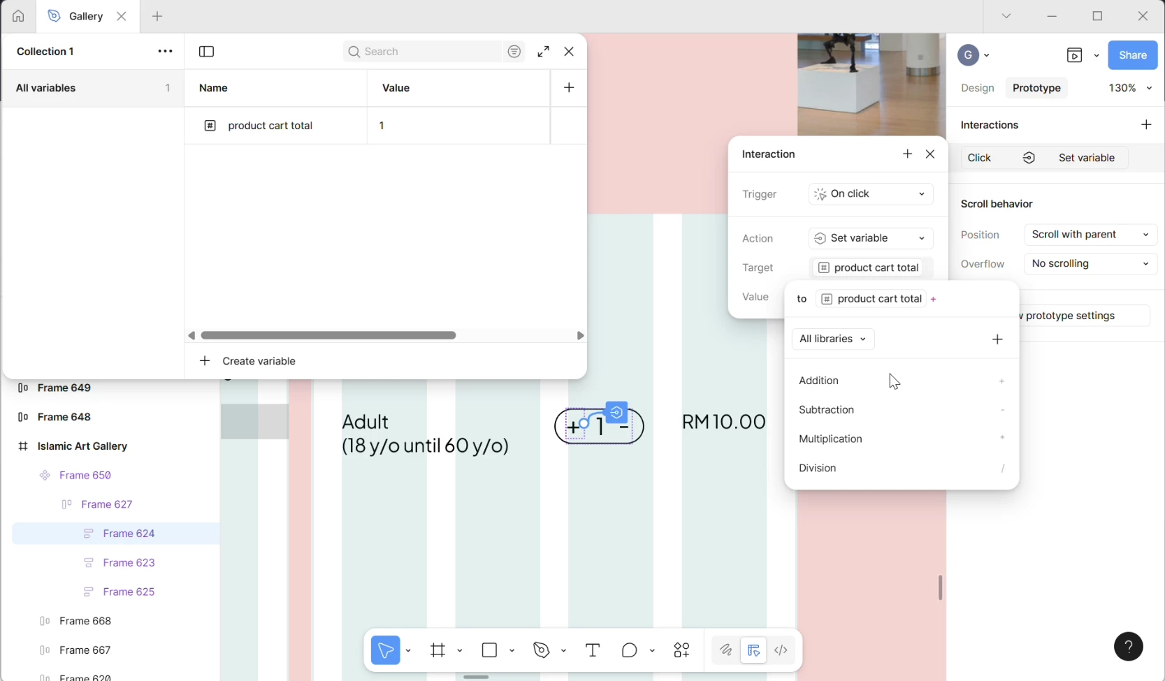

 Hi everyone, I try to attach the number with number variable as I want to make a functional counter. I already do the variable as in the picture below, but when attaching the number with variable, there are no variable detect(Pic 1). So, I need to type the variable. After type it in search box, the variable appear(Pic 2). Which my question is it normal? Because on my first attempted it the variable option was available and the process went smoothly ok. The prototype mode on + and - went smoothly (Pic 3). But when I try to test the prototype, only + and - are functional. “1” are not functional

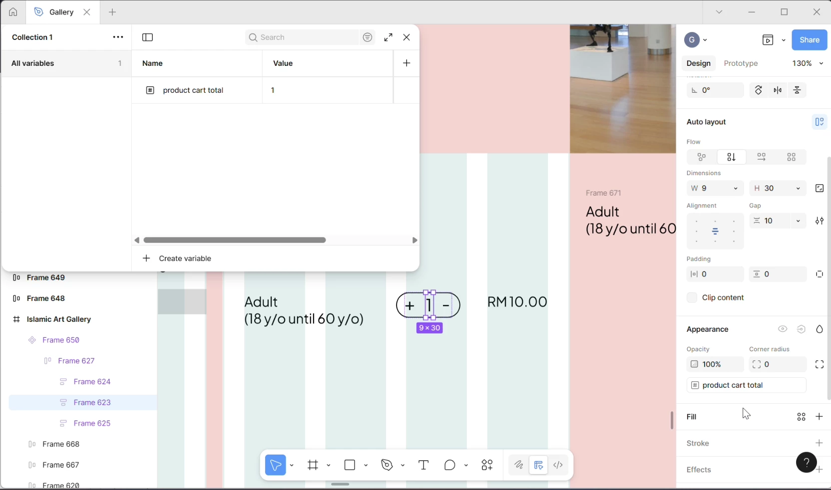

Hi there!
It looks like your variable is attached to the frame instead of the text layer inside it.
Try selecting the text layer that shows the number and connect your product cart total variable directly to that. Variables only work when linked to the actual text, not the parent frame.
Variable connection
Hope this helps!

Thank you so much! It makes so much sense now
