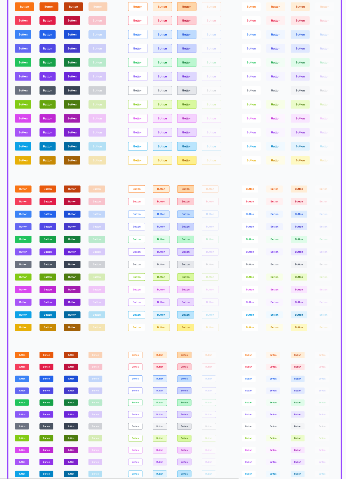

I’m trying to use the variables feature to reduce maintenance on some of our bigger library components. A good example is the button component, which currently has definitions for different colors/states/styles built in.
The problem is that this is a LOT of variants to maintain. If I could use variables to set size and color, life would be much easier. But I’m stuck on how to actually do that. My current best guess is something like:

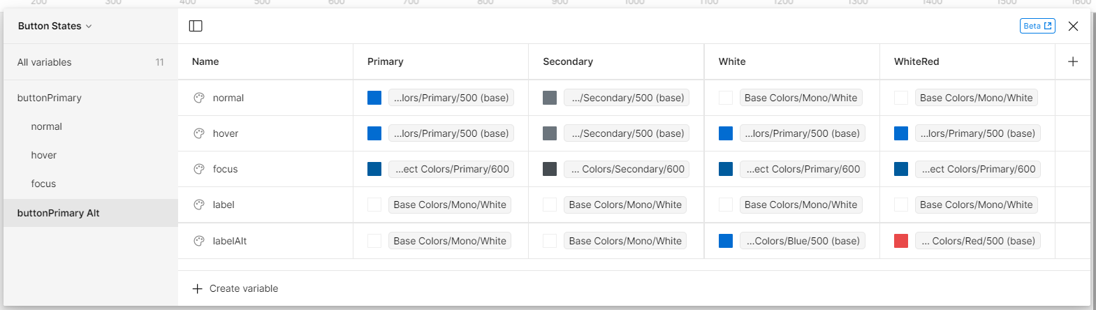

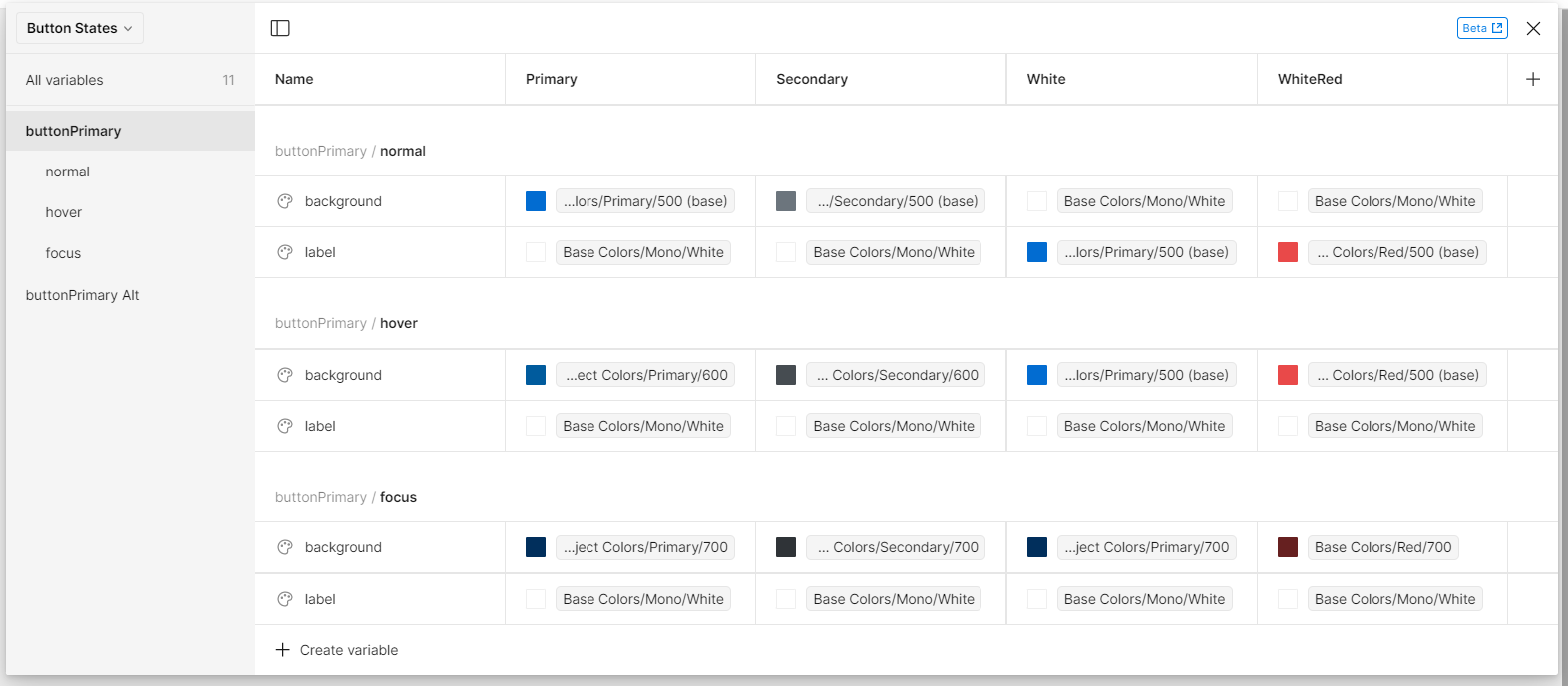

Case A
Having a separate subgroup for each state, two variables for each state to Background and label, and then as many modes as you please.
Once the variables are defined, you just apply both background and label color to each button state within the component set.

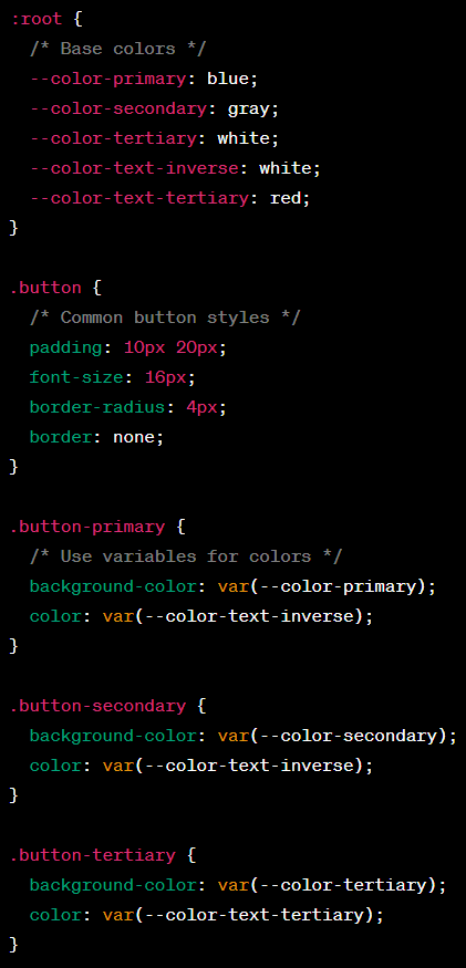

I think this structure is more similar with what we will see in css?
The only downside is that this table might not be pleasant to see.
Case B
In this case there are no subgroups, only variables for each button state, and two variables for the label: The regular and an alternative version.
I think this case is more complicated, as it requires you to select manually which variants of the button component will use regular label or alternate label.
But at the end of the day, the work in both methods are similar.
