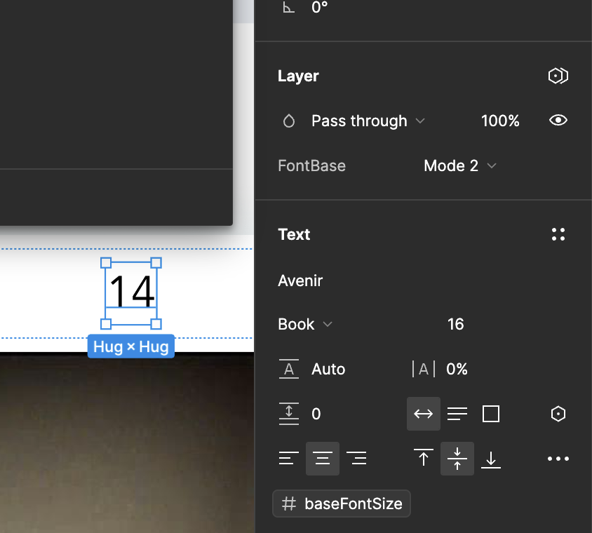

Sorry I can’t make it work. So I created a variable (type “number”) with modes
But when I try to select it for a text layer, it changes text content, not the font size
Arthur30Author
October 2, 2023
So “mode 2” is 14, but instead of applying it to font size, it just replaced the text of the layer
