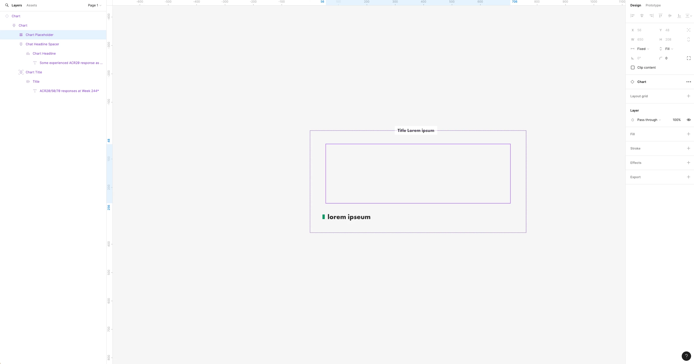

Hello, I need help. I’d like to make the HEIGHT of the ‘Chart Placeholder’ frame editable. How can I do this please?

You cannot directly change the size of an element in a component (you may change the size mode from fixed to hug|fill but that’s it)
What you can do is change Chart Placeholder to an instance swap element, so you will be able to swap it with any custom component that will have the needed height later on.

Thank you for your reply, i figured it out - i needed an empty auto layout frame because i did not want to use instance swap in this case.
