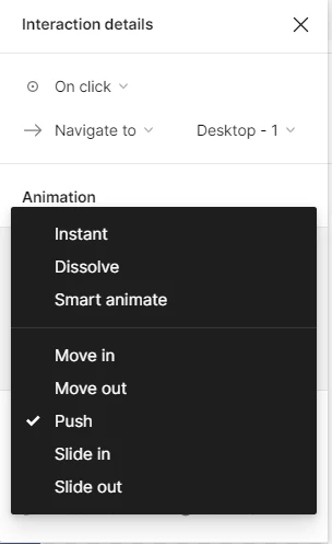

Mahdi_Vakili
August 12, 2022
Just found this awesome solution to this problem.
See by opening the menu which you can select either “smart animate” or “instant” from, you can see few other options such as “push” or “move in” etc.
