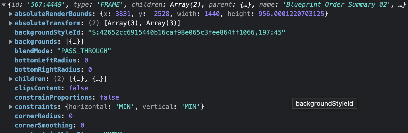

I am creating custom Figma plugin with JS, so, I receive data from the backend and want to convert it to a node so that it appears in the design. But actually I can not find methods of Figma API to release this idea.
Here JSON which I receive from my API

thank you for answer, but I already read the documentation and can’t find the way to transform my json in picture, to frame in design

yes, there is a very simple example, while this object has a lot of methods, I would like to find a live example of creating a frame that covers the entire stream, affecting all the fields that it can take, ask why I ask such small questions, but since some of these fields are read-only, some are generated, some are added not by direct assignment, but by calling certain methods, all this breaks my brain and I cannot create a frame in which absolutely all fields are filled, but while we communicate inside the frame , there are other types of nodes that the frame itself can take into a child field that also don’t have a fully scoped example, which is why I try so hard to find a live example

There are no “JSON to frame” methods. In general, you would need to do something like this:
const frameJSON = {} // your frame json
const frame = figma.createFrame()
frame.fills = frameJSON.fills
frame.strokes = frameJSON.strokes
frame.resize(frameJSON.width, frameJSON.height)
// ... etc
You can also search for “figma node from json” or something like that on github, I believe there might be a library for that to use as a starting point.
